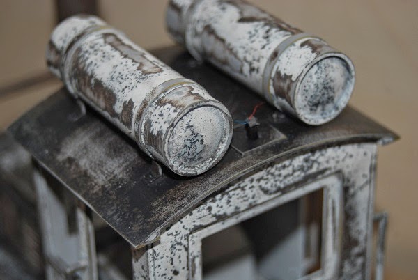

The entire rear extinguisher is a piece of aluminum tube, with turned brass caps. (head and base)
a couple of pieces like a valves and a piece of aluminum as Operation lever. The tube of the extinguisher into the engine is wire brass.
The rear light ripped
