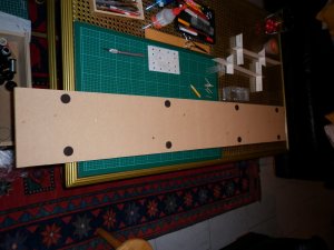

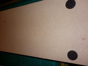

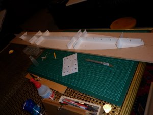

After a long time gathering courage I started two years ago with the 1/200 GPM Prince of Wales.
I decided to build the model as a waterline model because of two reasons: the first is that all other models I've seen are full hull models, and secondly my other two ships (the 'De Ruyter' cruiser and 'Schleswig-Holstein') are waterline models.
I'm also thinking of placing the ship in the water, will try to create a baseplate that resembles the ship slicing the ocean. Maybe with Japanese bombs missing the ship closeby :-)

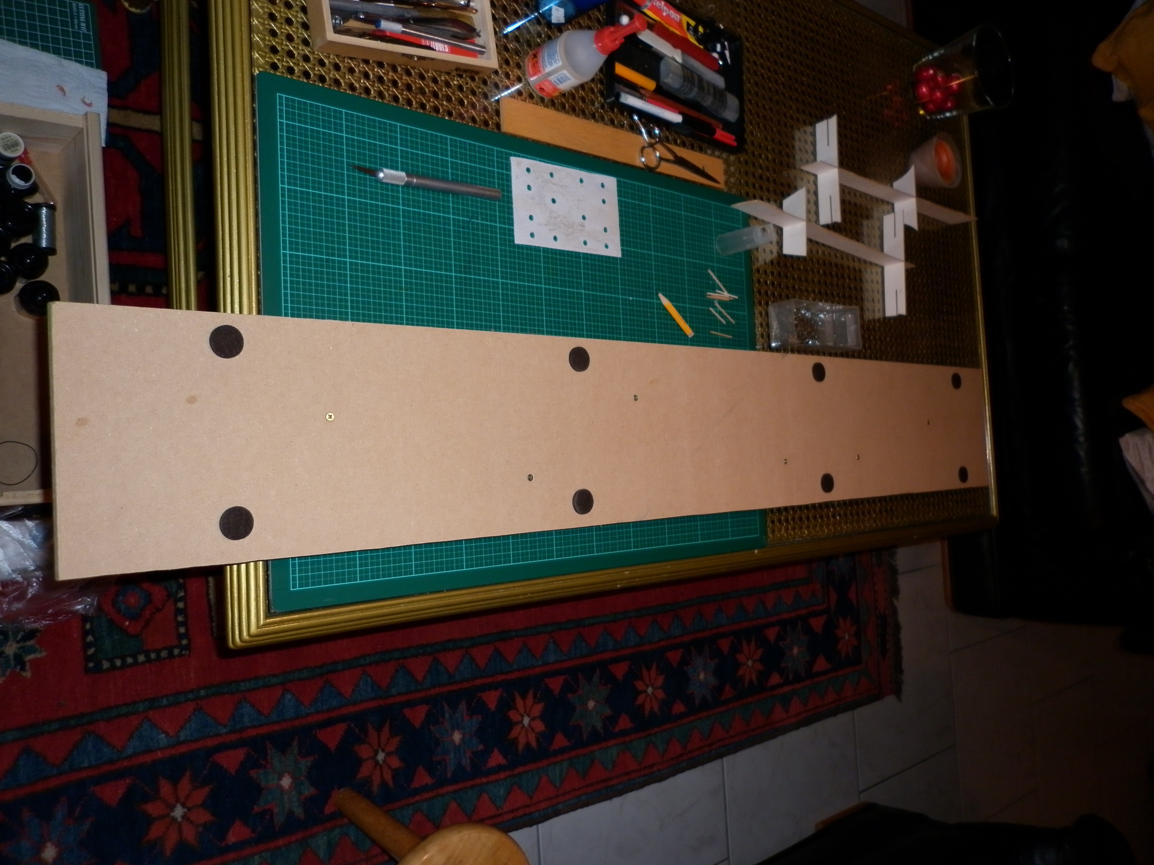

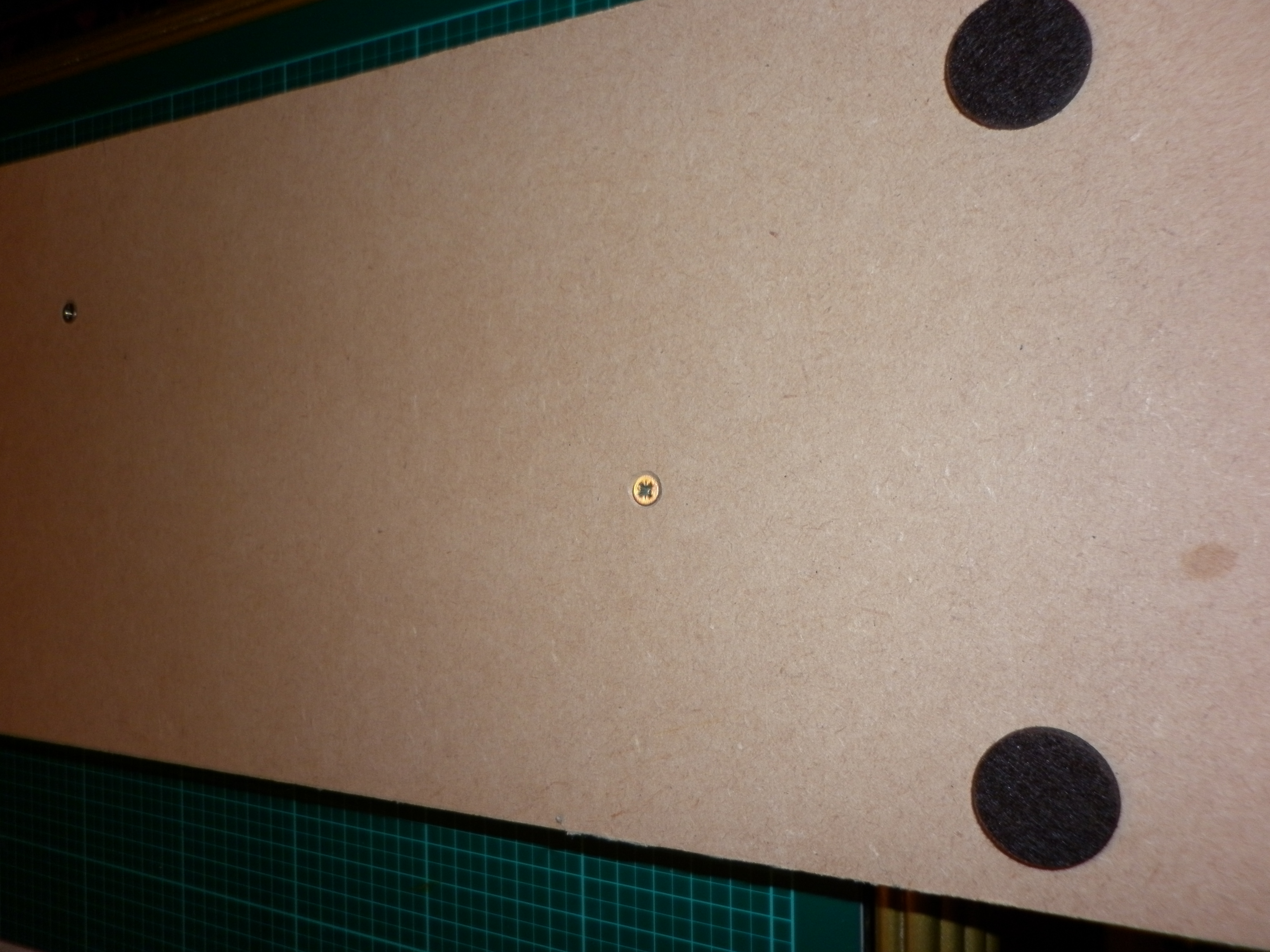

I thought it a good idea to build the ship on a baseplate for rigidity. Slight problem: because I have not decided how to create the 'water' I thought it a good idea that the ship could be removed from the base plate because materials like mache is created using water.
So I decided to screw the ship from below onto the baseplate with small screws. This way I can remove the model easily and simply attach it later on. Hopefully..

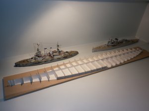

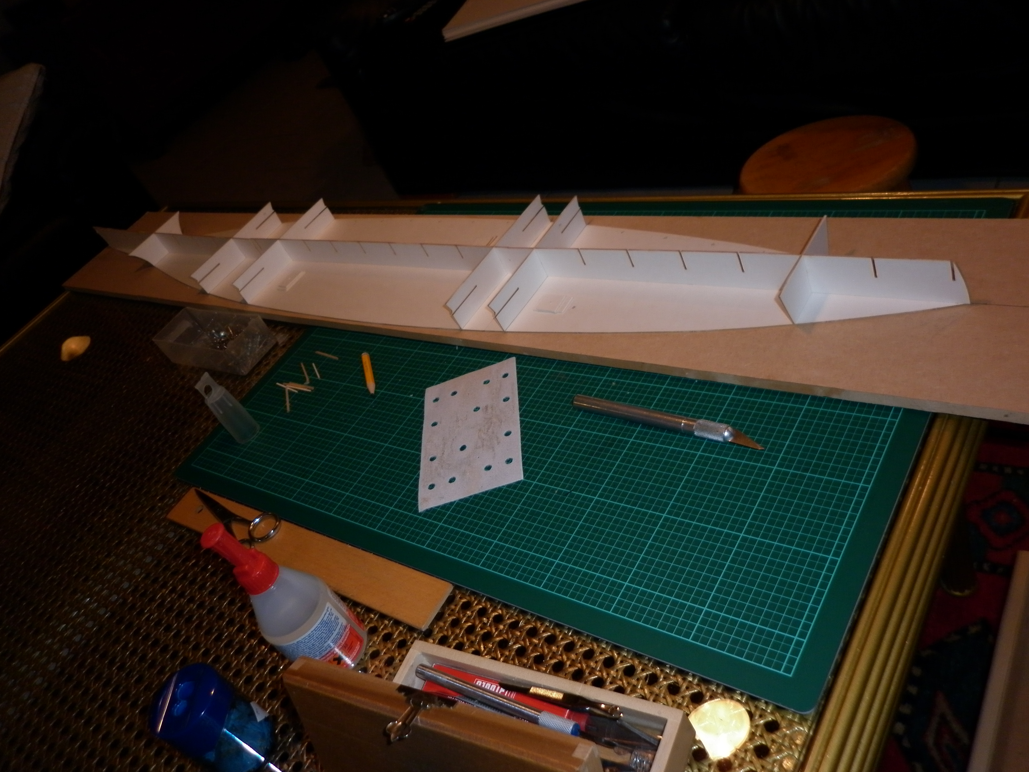

Next. most trusses are standing now, with one cross connection of the four. To give an idea of it's size: behind it are the De Ruyter cruiser and Schleswig Holstein in 1/250.
Reactions: Lighter

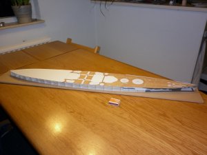

Hi friends,

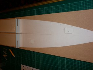

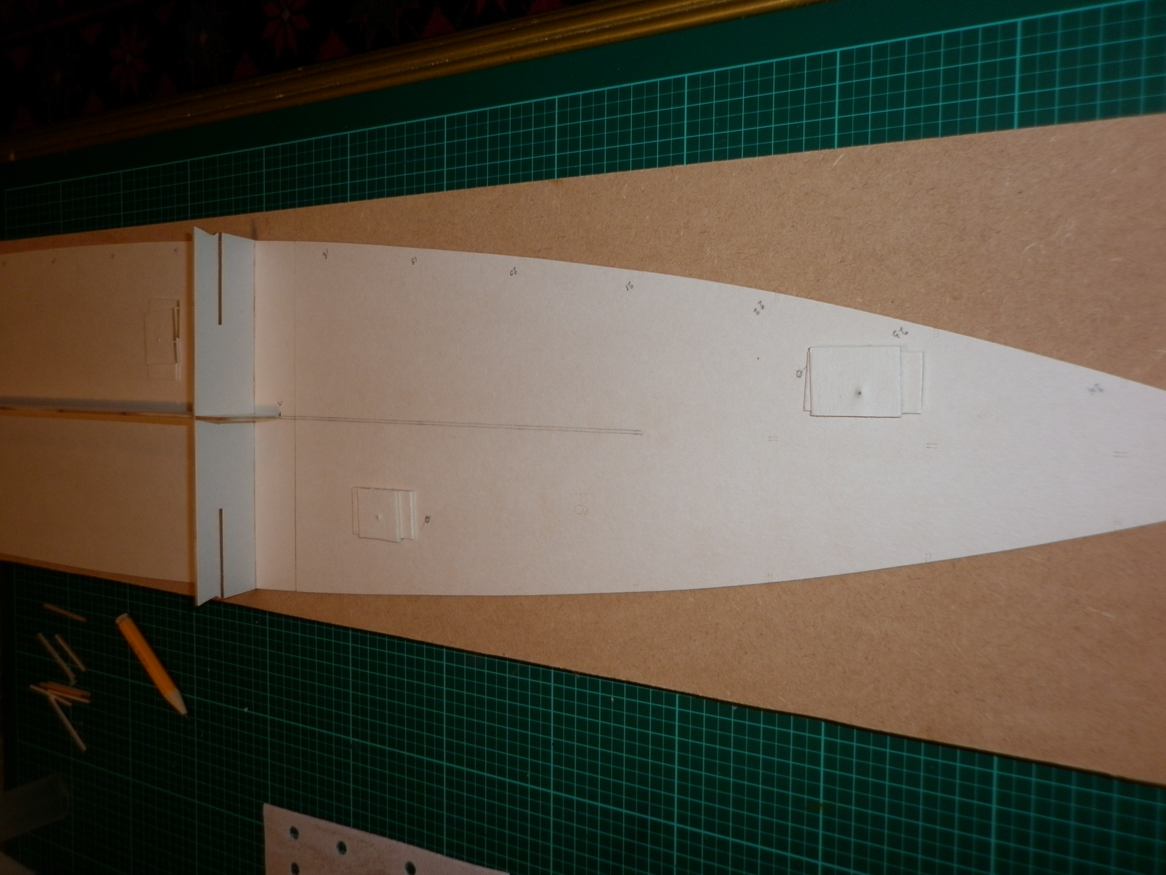

Added the front and middle deck and the left and right bowplates.
The bowplates needed adjustment; from 1,5 up to 3,5 mm needed to be cut off (from the black waterline side of course :))
In the GPM model the anchor chain drops into into the cabletier through little open holes in the deck; the hawseholes are open too, so the inner sides of the model are visible.
So I added three 'pipes' under the deck for the cabletier and painted them black. Same with the hawseholes. This is a little bit tricky but trial and error solved it.
After this I glued the bowdeck on the model.
Next I will add the stern deck and plates, I expect I will have to adjust them too. Paperfan gave the answer : "The black waterline stripe is afterall not entirely above the water line." Thanks Paperfan

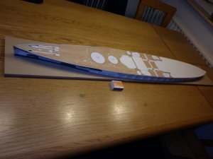

Next update :
The hull is closed, I started with the basis of the main gun turrets and breakwaters.

Anyone building a ship would have to be really brave or foolhardy to show a picture that big. You pulled it off though. Not a seam to be seen!! I love science fiction, but reality based models like this are so refreshing, and I believe pay homage to those brave souls. The Interview with one of the survivors of her destruction brought me to tears. This ship really is being brought forward by your build. I hope many read her history to find out what happened, and understand the tragedy. :)

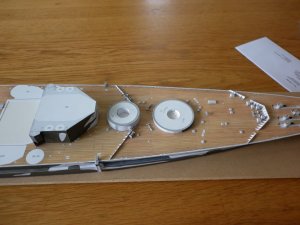

Had to leave the country for some time.
But, I'm backagain :)
Continued with the bowdeck hatches, venting, anchor stuff. Process is slow but sure ! These tiny parts take a lot of time, but they add a lot to the model.
First part of the superstructure added.
Fantastic detailing. Anytime you can take a picture that close and see now errors says it all. A picture speaks a 1000 words. The bow section has really sprung to life! :)

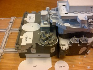

Started with the superstructure for the bridge and the hangars. Not everything has been glued yet.
I cut out the rectangular windows and glued plastic from an overhead sheet behind it. I thought that it would look better this way.
The airvent on top of the hangar structure has 90 lamellas. 1,5 mm * 14 mm. Took me three evenings to get it as straight as possible...
It's a major project, but I enjoy it !! Taking my time though
Reactions: zathros
I never saw such detail of the hangers. that was very educational, and a pleasant surprise!! :)

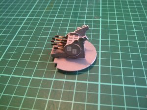

Started with the pompoms.

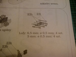

For the barrels GPM wants us to wrap tiny pieces of paper around a 0,5 mm metal thread. I tried that but the result was quite unsatifactory.
Then I remembered the wire that I used when soldering electronics.
This wire is 1 mm thick including the isolation, the copper thread inside 0,5 mm. Coming close to the specs from GPM, and the picture of the pompom on the ship.
In order to get the two types of barrels (long and short) the same size I first made a template.
I pierced the gun mainbody with 8 holes,
cut the barrel to the right length, cut the isolation for the mouth of the barrel and slipped that off. Then I cut the length for the base of the barrel, removed the unneede islotaion and pushed the barrelbase to the disered place. Lastly I glued the barrelmouth on its place, leaving 1 mm to the end of the barrel thereby creating an 'open' barrel.
I could not think of a way to make the barrelmouths spherical however. Anybody an idea ?
After completing the pompom I painted the barrels gun metal. Looks ok to me :-)
Reactions: zathros
You can heat the insulation, use a pen with that type of conical end, and with you heat the insulation, push it onto the pen, let it cool and you will have your shape. Your build is incredible. It makes seeing documentaries of this ship all the much better. I find myself looking for the Hanger doors. That must have been one busy crew!!
