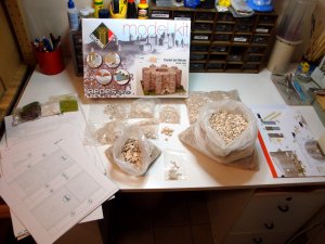

Last year, for my birthday, my sons gave me a great present (they know how to make me happy :) ) a construction kit from spanish Aedes Ars, a beautiful castle all made by little pieces of something that looks like stone (but I think is much more likely some kind of resin). The subject is an incredible building.
Castel del Monte is a fortress built by emperor Frederick II during 13th century in southern Italy.
I was there some years ago and - can assure you - that place is absolutely fantastic, nothing similar exist in all medieval architecture. Really a magical place.
The model itself is something I never tried before. I'll have to experiment totally new build techniques. The "bricks" will be glued to cardboard templates so, eventually, what I'll have at the end will be a cardmodel covered with stone. I'm not totally off topic after all ;).
This is what the kit contains: some heavy cardboard templates (unfortunately they are pre-cut and some of the printed line is not perfectly aligned with the cuts so I'll have to decide if I should follow the cut lines or the printed ones) two instructions posters (not shining for clarity) and an HUGE amount of little bricks in several different shapes and sizes, plus some special shaped parts (for windows, columns and other architectural details). There are also three bags with diorama stuff to simulate grass, bushes and gravel.

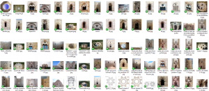

I studied carefully the photos I've taken on site, a couple of books I have on the castle and some of the great amount of documentation found on the web and now I'm considering some enhancements and corrections to the model to make it as realistic as I can.
The first part I want to do is to scan the cardboard templates to correct the shape of gates and windows. Then I'll print the corrected templates and I'll start building on them.

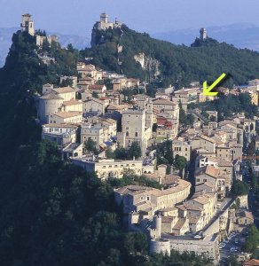

in fact I actually see Him everyday out of my windows and can talk directly with Him to say Thank You for this wonderful world we have here.
(the photo isn't mine, I've taken it from the web, but this is what I actually see almost every day from here!)

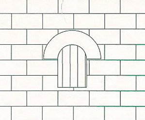

Studying model drawings I realized there are many imprecisions in design of architectural details.

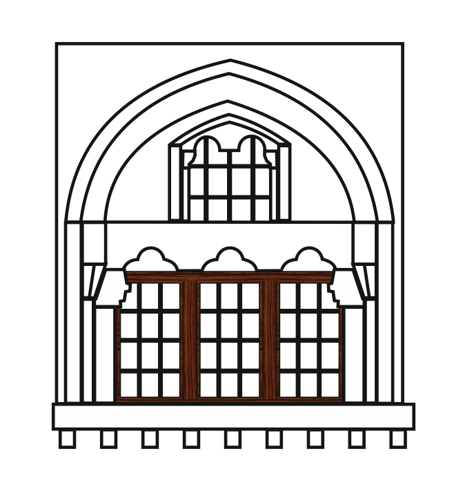

First of all I scanned all the cardboard parts and outlined them in CorelDraw to have a starting point for my digital editing. Then, looking to the photos, I am correcting all that's wrong to arrive to a decent construction reference for my bricks.

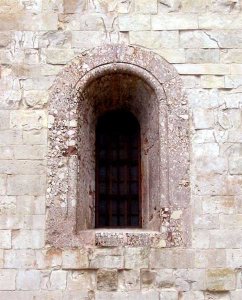

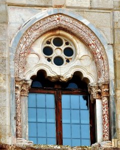

This is the real wall

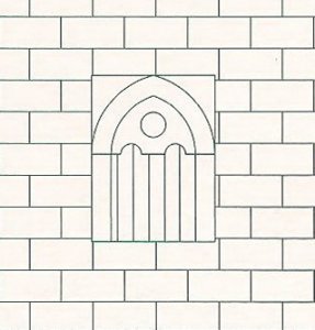

This is the same detail on the actual model part
And this is the outline of the same piece taken on the scan
As you see the arch shape is completely different and the window it has nothing to do with the real one.

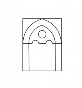

This is my correction. I still don't know how to realize the finest window details. The wooden frame will be probably made with cardboard (so it will be worth publishing here at Zealot). For the remaining stone details I'm thinking about realizing a master in plastic and to take a silicon cast to make copies with some casting material (like plaster or resin...).

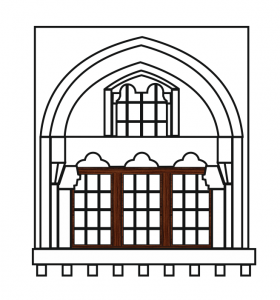

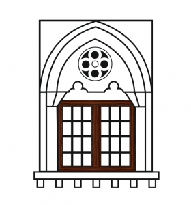

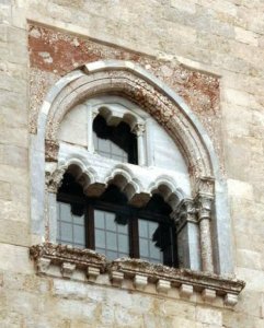

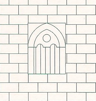

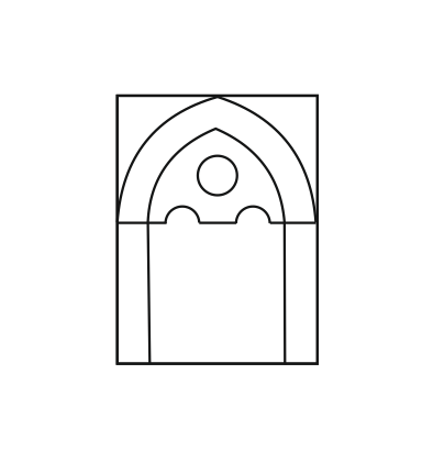

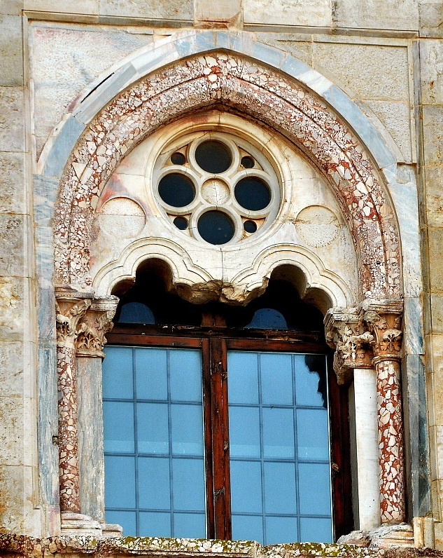

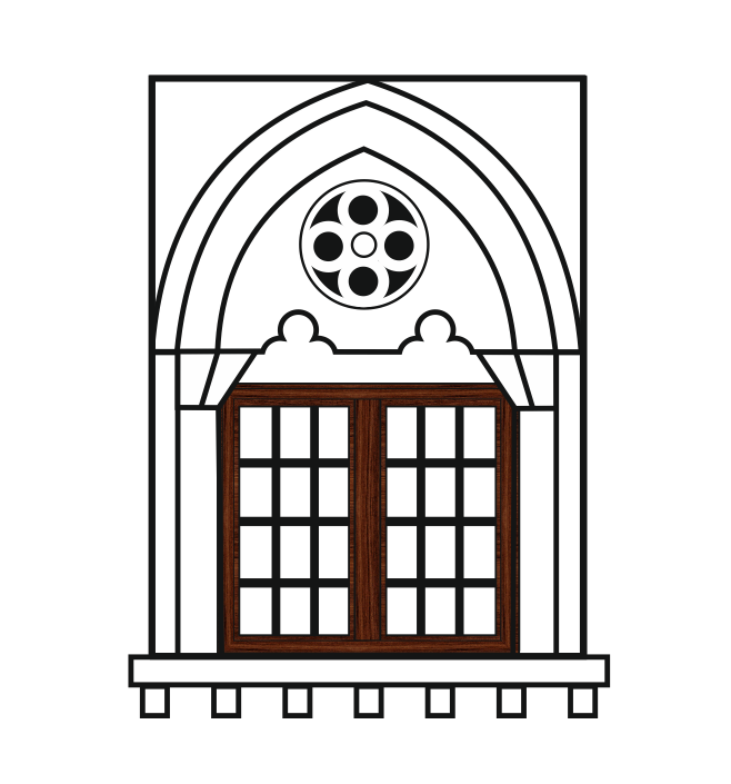

First of all a look at the windows. As for the inner court windows, the external was completely wrong in the original model design. They was simplified to be buildable with the kind of bricks and architectural pieces that are available from the producer's catalogue... I won't limit to those bricks and want to build components that looks like the real ones as much as possible.
First the "bifore" (I don't know the English term: they are windows divided in two vertical section by little arches)
This is the real window
this is the original model part
This is the outline of the above
And this is the window I want to put on my model

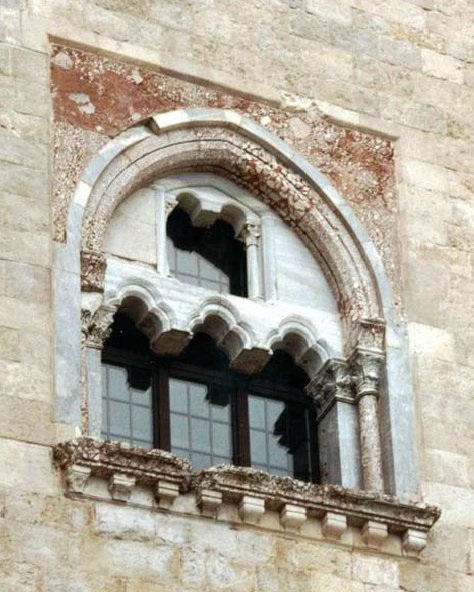

One of the windows was a "trifora" (3 arched window)
The model didn't provide at all such window...
...so I drew one for the purpose

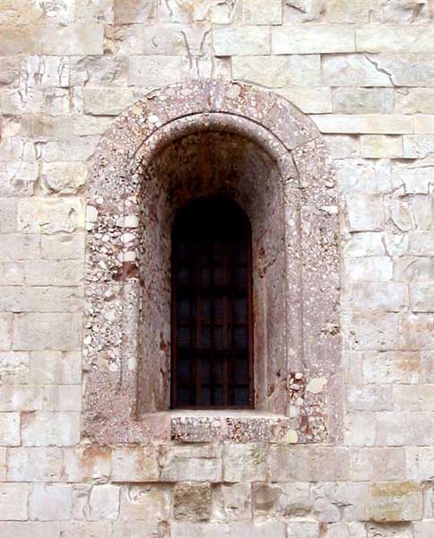

The lower windows in the real building
The original model draw
...and my version.
