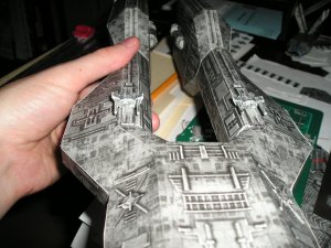

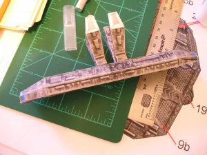

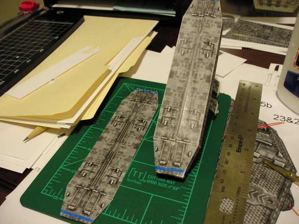

Here's a new update on the Defender. Here's a pic on the bottom of the shuttle bay.
As can be seen the bottom doesn't line up too well. Should we scrap? NO!!! Why redo it when you can cover it up.
I printed up another shuttle bay, cut, and glued the relevant areas together.
Since the area that I want to cover is flat, it makes it that much easier.
New covering on the bottom of the bay. Everything is now lined up.
Here's a side view:
I hope this helps out anyone out there that's had problems like this.

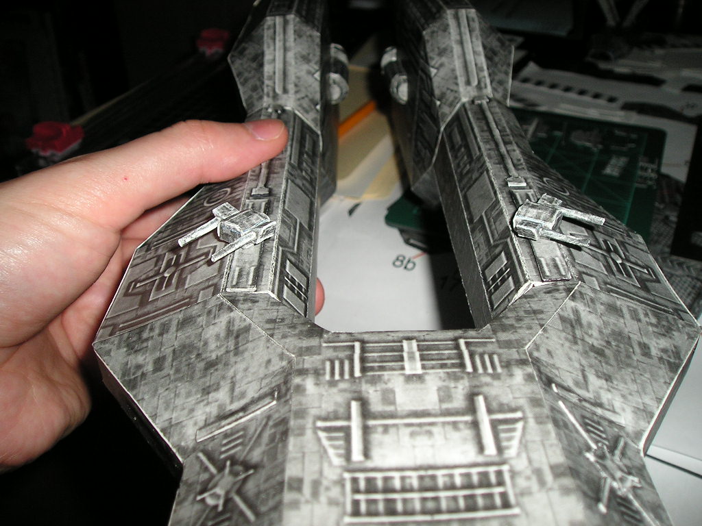

Ok everyone here's another post.

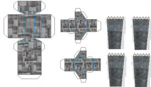

This was the original design for the turret.
As you can see by the design the original designer has NINE parts for this and they are TINY! I decided that if 10 turrets are required for the ship that cutting out 90 teensy parts was out of the question (I thought it was just plain NUTS).

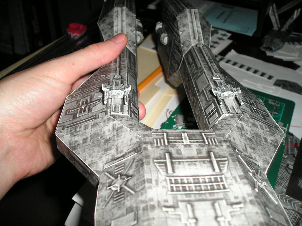

Thus, a new design for the ship was necessary that used fewer parts and a slightly bigger turret (my first design - from scratch).

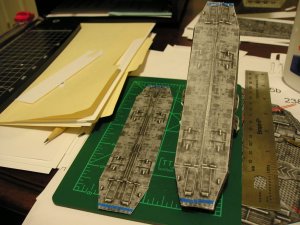

Here are the turrets on the ship.
Forward facing - hard to see when looking at the side.
OR
Canted roughly 45 dregrees.
Which do y'all out there prefer?
I'll try to upload the design of the turrets later.

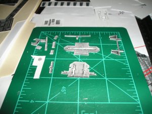

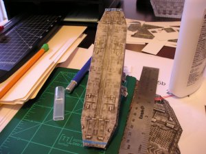

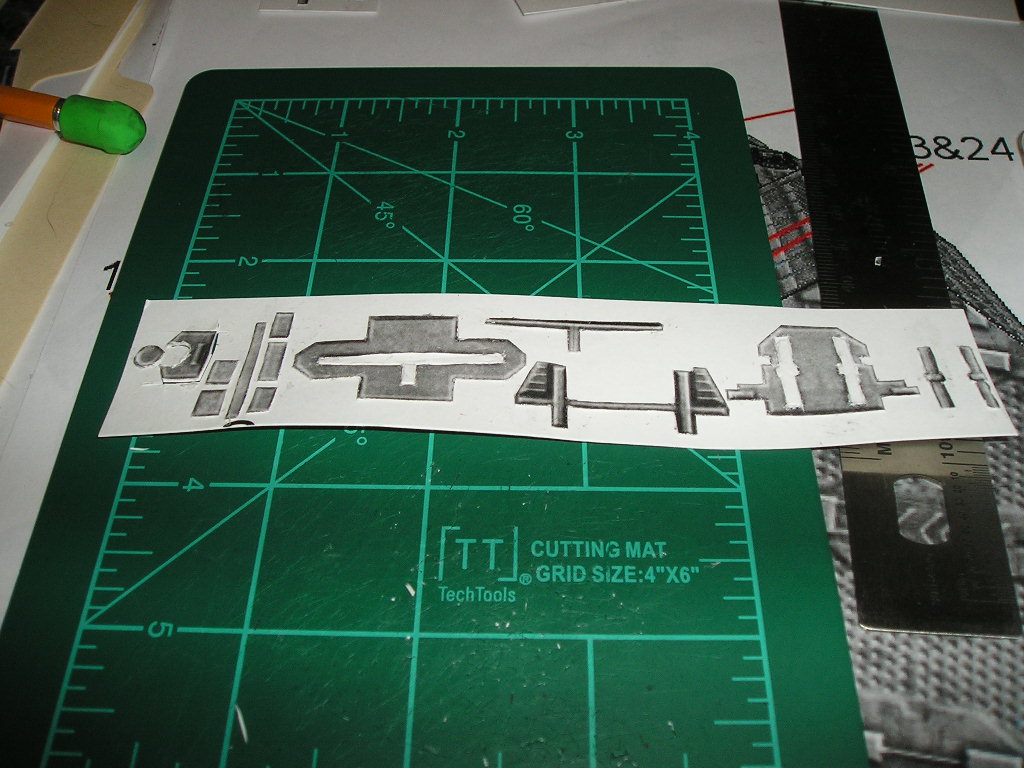

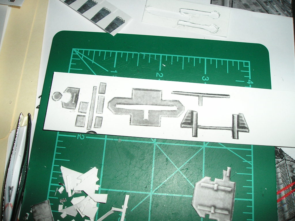

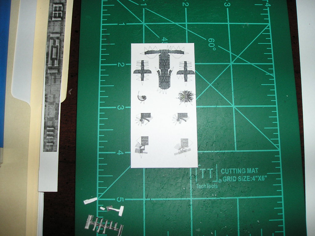

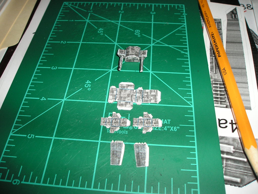

Greebling attempt for the Defender.

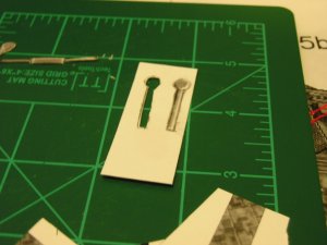

Trying to greeble for this model is interesting in that everything seems to blend in with the background of the ship. So multiple layers are required to raise the surface features of the ship (as mentioned in an earlier post).

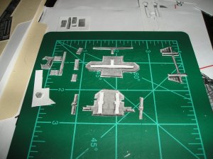

What is done is you cut out the desired surface feature and glue it on top of another blank (or not so blank) piece of cardstock. Next you follow the outline of the desired shape with your knife.
For raised features on a feature you've already cut out you could do it a couple of ways:
#1 you could reprint the feature (wasting additional toner and ink) or you could #2 cut out the feature you want to raise (I opted for option #2).

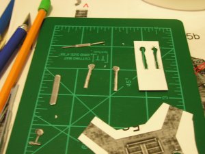

As you can see in the image above a "t" shape was cut from the central section of one of the pieces. Another piece of cardstock was cut out and added to the cut out area where the "t" shape piece was removed on TOP of the new piece of blank cardstock. In the lower right hand corner of the picture you can see another piece before cutting is done.

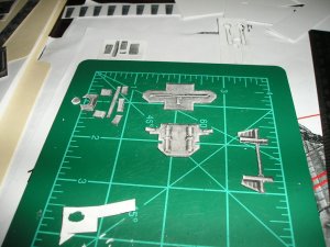

The lower right hand piece added to the card stock backing with the desired pieces for raising cut out located to the right of the piece.

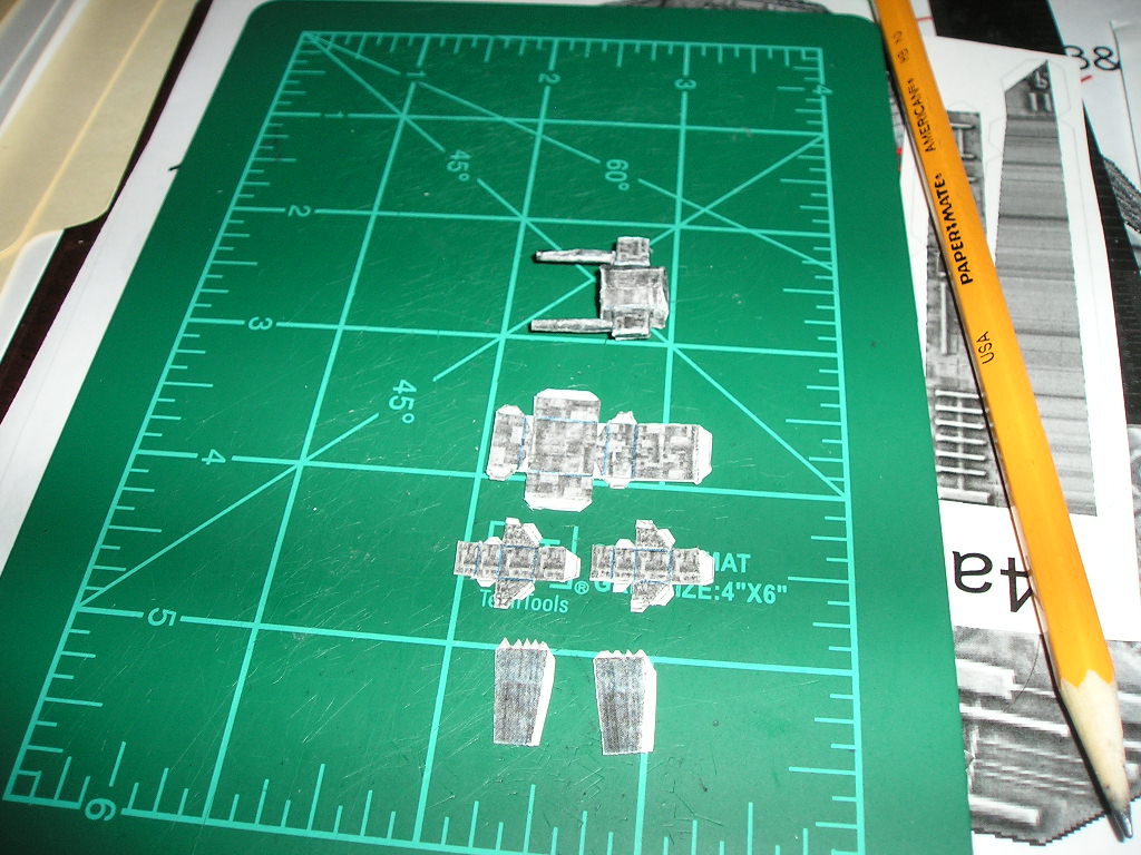

Next the pieces are cut out.
The main pieces that had the cut out area are white due to having a matching piece of cardstock cut and fit to the empty area.
The pieces that are to be raised are glued on top of the main pieces.

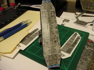

If you notice the edges of each piece have been colored with pencil. You could also use a black marker as well for this ship. This is done to cut down on glare and have the pieces blend in better with the ship since everything is in shades of grey, black, or white. This is done BEFORE you glue the pieces to the model.

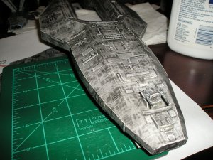

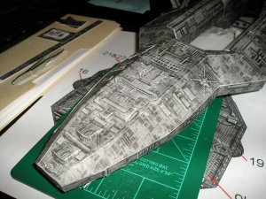

The greebled pieces on top of the ship.
I hope this helps some of you out there trying to make this ship.
Sky Seeker

I would add one ring around the base of each barrel to make them look like they compressed wen the shot, eye candy, or not. I found this neat pic. If you glue the turrets, you won't be able to aim them!!! :)
Sky Seeker
If I don't glue them the galactic kitty cat will start swatting them around the "spaceport". Thanks also for the pic.
Skyseeker, that is one awesome looking model! I love all the "greebling" you've done. The turrets look great! I especially like them at the 45 degree angle. Good quality pics too! chadepotts
Reactions: Sky Seeker
