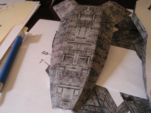

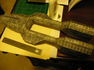

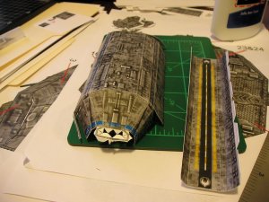

Top View - front section

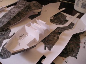

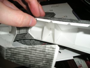

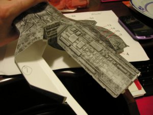

Front section bottom side with reinforcements.

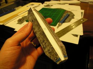

Top and bottom front section assembled with reinforcements in between.

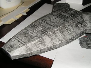

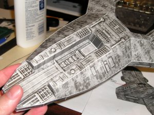

Bottom view front section assembled.
Top view front section assembled.

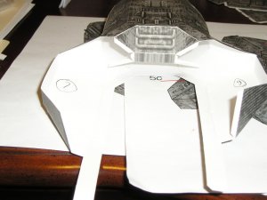

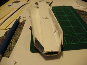

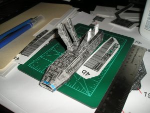

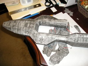

Back view front section before mid section is joined to bottom section and pre-assemblage of the mid section.

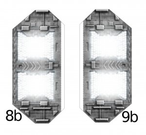

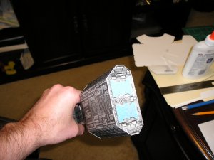

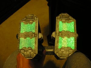

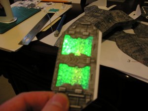

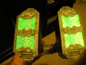

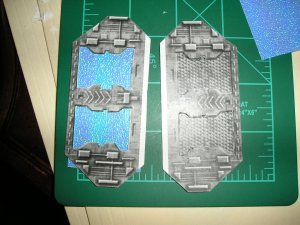

The old design of the main engines just had a grey matte background with a series of bumps (right), I decided to add something a little different to the engines using polychromatic paper (left) with raised ridges and changes color in white light. I was originally going to a foil with crinkled ridges, but I couldn't find the right foil. So I opted for this instead.
The "paper" in a different light.

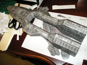

Application of the top of the mid section.
Reinforcement of the mid section.

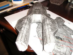

Here is the mid section fully assembled.

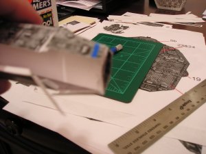

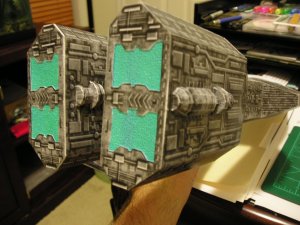

This is the addition of one of the the main engines.
End view of the engine.
The engines actually were pretty tough to get on. I added bulkhead reinforcements internally to increase the strength of the structure. However, I wasn't satisfied with what I had, so I added some strips to attach the main engine to the mid section.(see below).

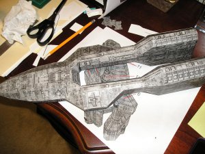

Assembled ship with engines (top view).
End view (engines)

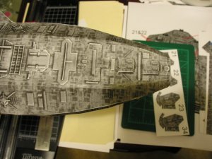

Hello everyone. Just thought I'd finally upload some new pics of what has been done so far.

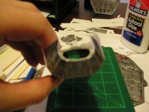

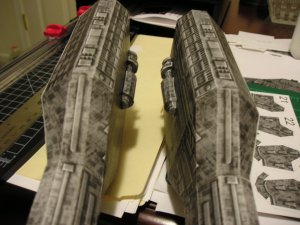

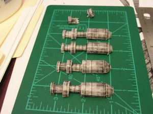

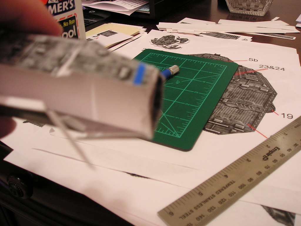

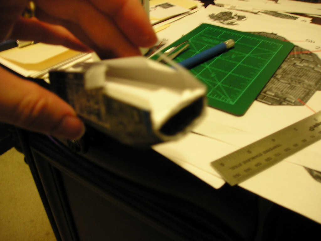

These are some engine pods for the left and right sides of each engine.
The badly mauled sections at the top are the result of NOT scoring the paper before folding. For those of you out there totally new to paper modeling it is ALWAYS a good idea to score first before folding to get crisp folds. Some people use an X-acto knife to LIGHTLY score a fold. I usually end up cutting through the paper with the knife so I use a pointed slightly blunted metal tip and trace over the fold lines multiple times before folding.

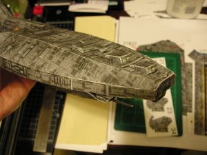

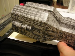

This is the forward bottom with forward turrets and a main gun.
Right back side.
Front view of the engines looking back with the inner engine pods.
Back view of the pods from the engines.
Top view of the forward section.

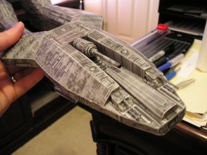

Front oblique view. Note the additions of the command centers on top with a view of the right bottom turret below.

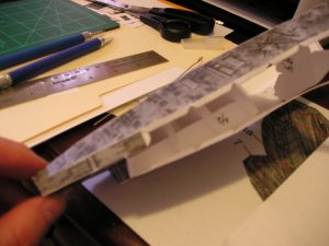

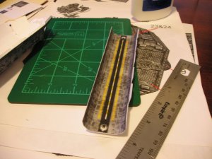

Inner runway of the launch bay.
Inner runway with the outer covering of the launch bay.

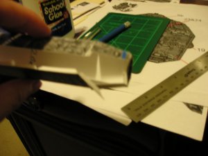

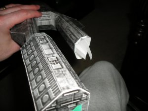

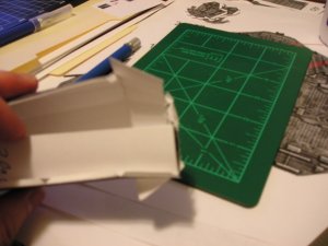

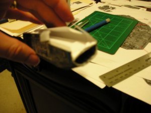

Here are some pics of the construction of the landing bay.
Inner runway folded and joined to the forward end of the outer covering of the launch bay.

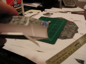

This is sort of hard to see. The tabs of the forward covering were very hard to assemble to the runway (and vice versa). You had an inner set of tabs for the runway and an outer set of tabs for the outer covering. Looks easy until you actually have to assemble it. I actually tore one end off. Fortunately, the upper glue tabs were able to be used to glue the opening in place to the outer covering.
The launch bay just before full assemblage.
The launch bay fully assembled with the connecting struts on top.

I did promise Zathros that I would greeble some of the surface features on this model. One thing I have noticed with greebling on this model is that for some of the smaller pieces they have a tendency to blend in. In one of the pics with the bottom turrets the section that the turrets are attached to have been greebled, but you can't see it because it blends in so well with the surrounding environment. I think that when you have a model with mostly shades of gray, black, and white it's easier to hide with the color. It's great for hiding mistakes, but lousy for bringing out surface features, so placing multiple layers on the surface will have to do. That will be featured in future posts.

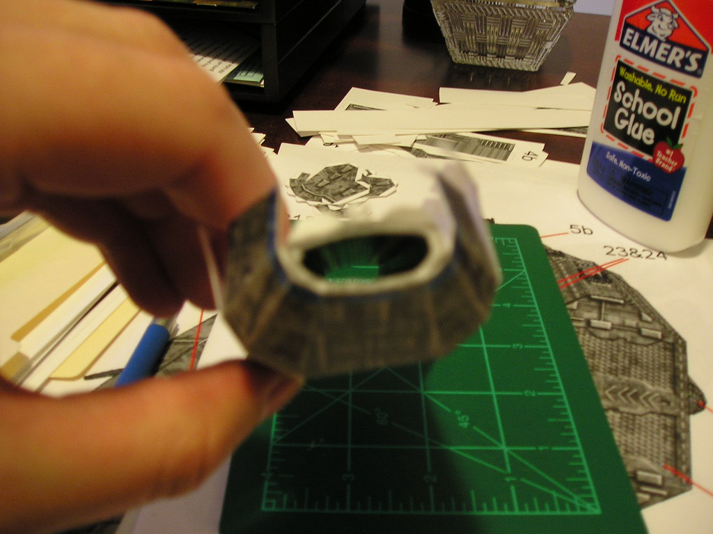

One thing I would change: Make the engines recessed. That would add a 3D effect to them and enhance the impact. Other than that the build is coming along beautifully. :)
Reactions: Sky Seeker
Revell Fan,
That's a great suggestion! :iagree: I think in this model that would be difficult at this stage. Of course I'm open to suggestions as to how to accomplish that. (:vulcan: - with an eyebrow raised)
The ends could be cut out where I have the polychromatic paper. Then a box with an open top can be made about the size of the engine openings. Next, cover the inside surfaces with the polychromatic paper, then join it to a new back engine cover (with appropriate cut outs) that covers the entire back end along with the current back end engine cover. Hmmm.. that could be do-able.
Turrets and greebling take priority first before I start performing surgery like that.
Sky Seeker
If it is too hard, extend the end out. I'm sure no one is going to your house with a measuring tape, and the effect would be the same. :)
You'd be surprised...
I think it would be easier to cut the back in certain sections and glue new back engine sections than to extend the length especially after greebling and adding some turrets. I'll see what happens after I'm done with the other stuff.
