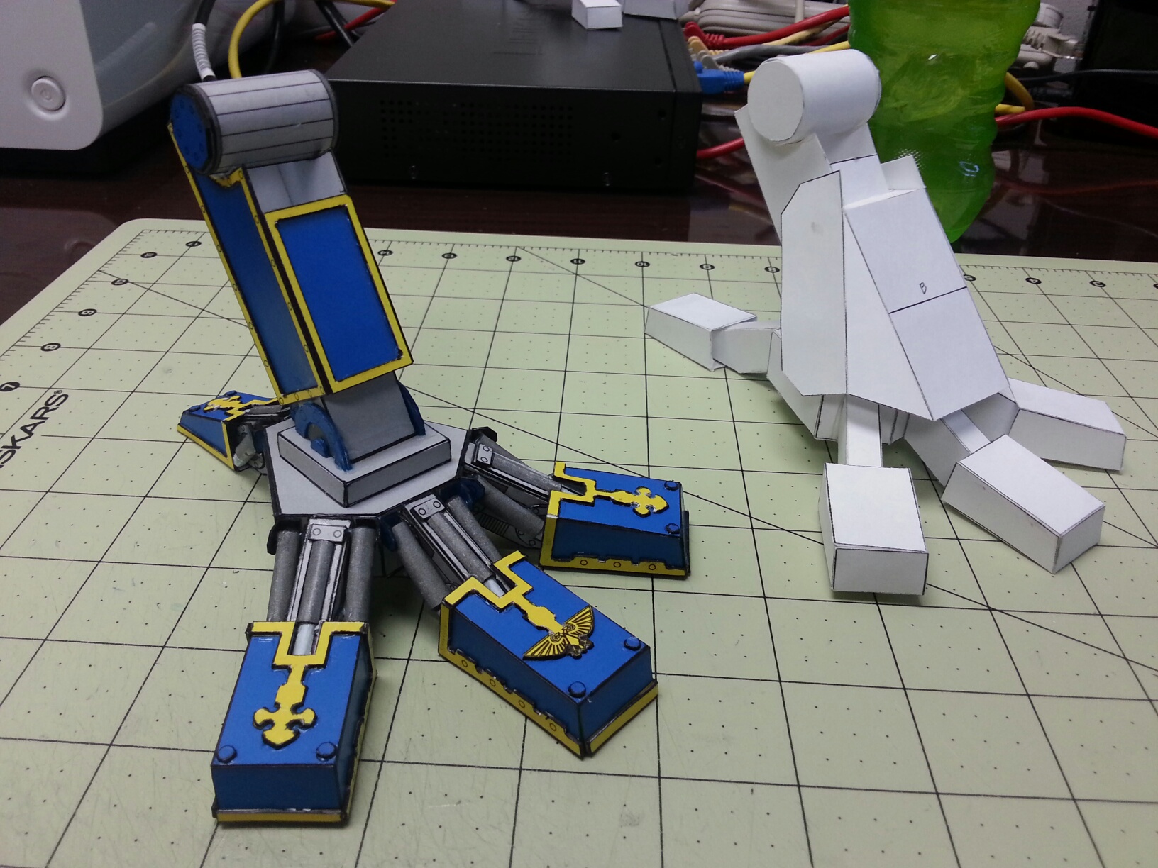

The new foot compared to the old foot.

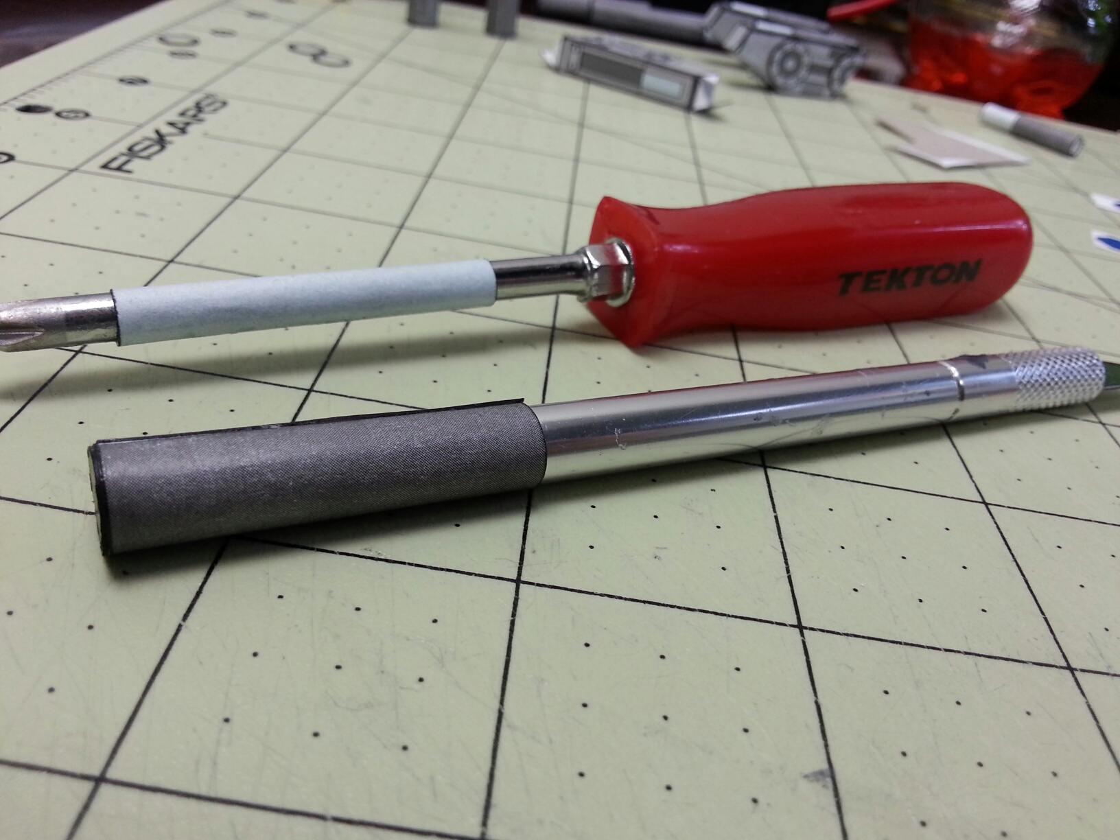

This is about my lucky piston. A simple hint is to use anything you can to make things right. You can see that I tightly wrap one part around a screwdriver and the other around an Xacto knife. With that done, Now, I glued all of my pieces in place. (except for the opening.)
20140806_095542_resized.jpg 20140806_100006_resized.jpg 20140806_100135_resized.jpg
I actually started doing this in the opposite manner. Glue the open end first and the piston end. Once dry, slide them together and seal both ends. I also found that this particular piece is about the same size as a standard hole punch. So much easier than cutting by hand.
Here is a good hint. If you ever have to glue something that is very close to another thing but don't want them to be permanently stuck together. Put some glue on an extra sheet of paper. then use your finger to transfer the glue into the place you want, lightly. Once you have the glue in place, set your piece. This is all done very carefully.

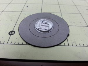

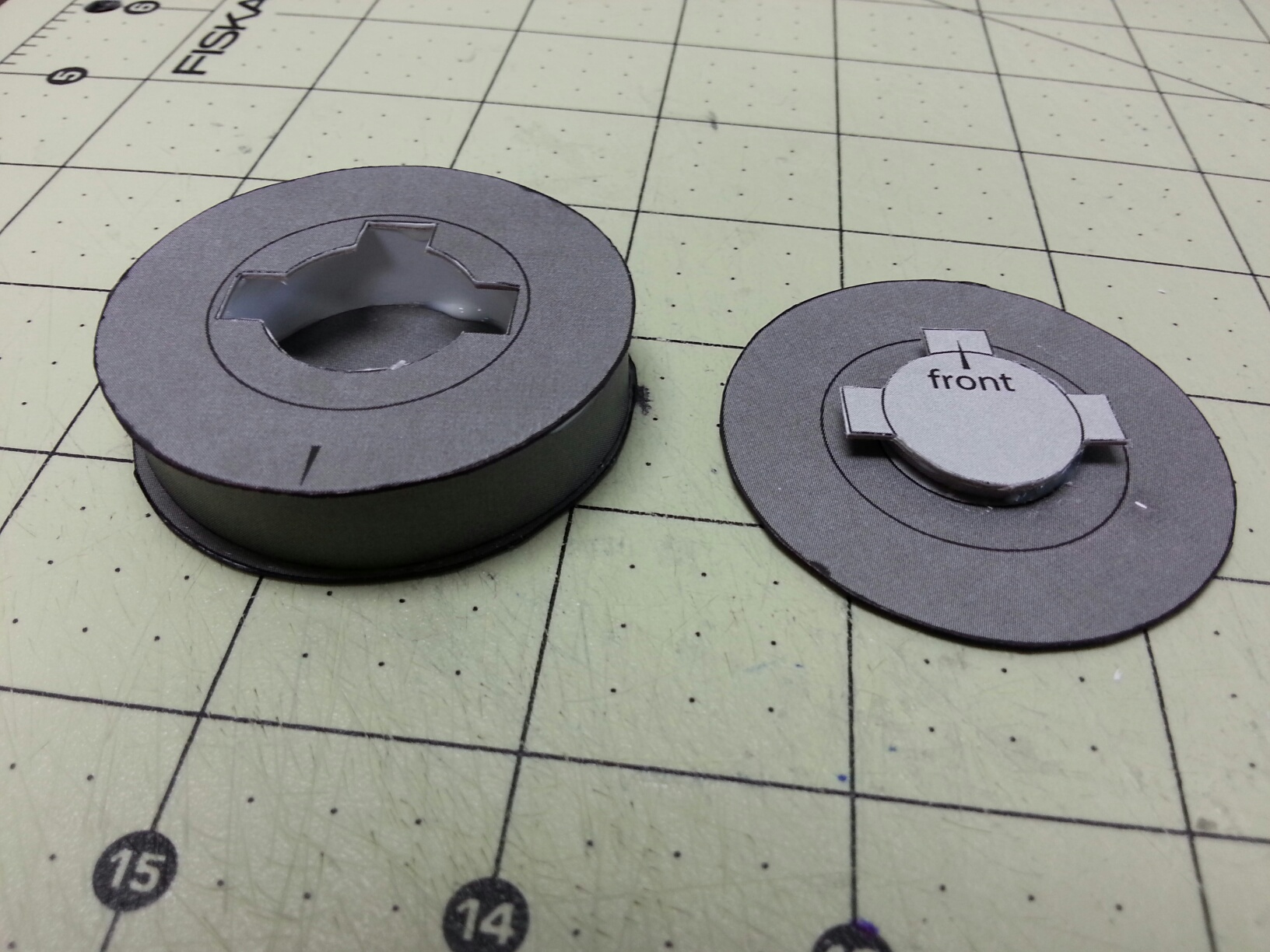

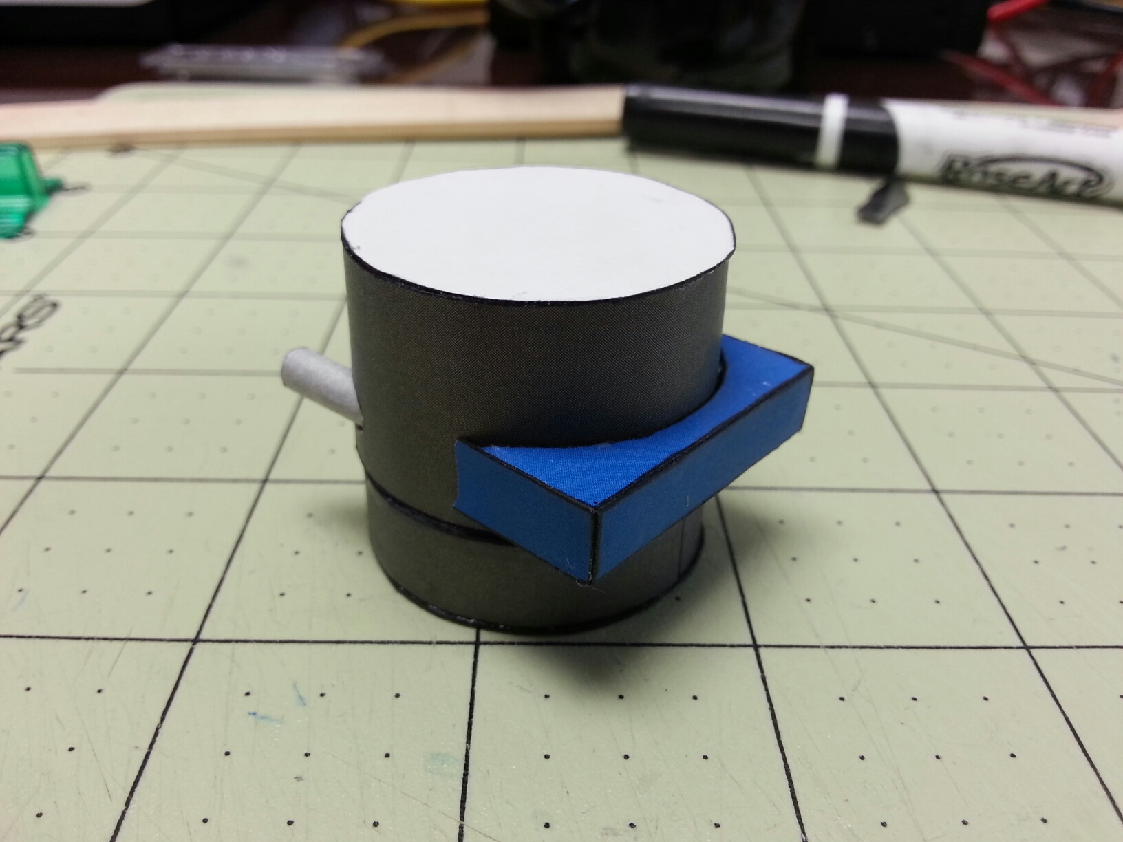

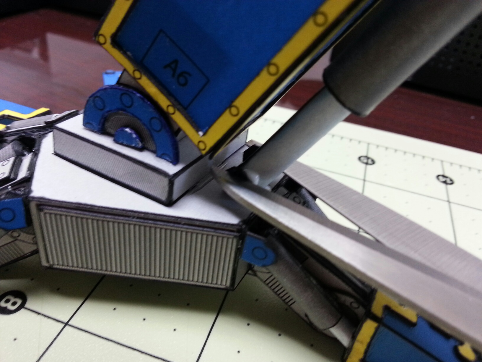

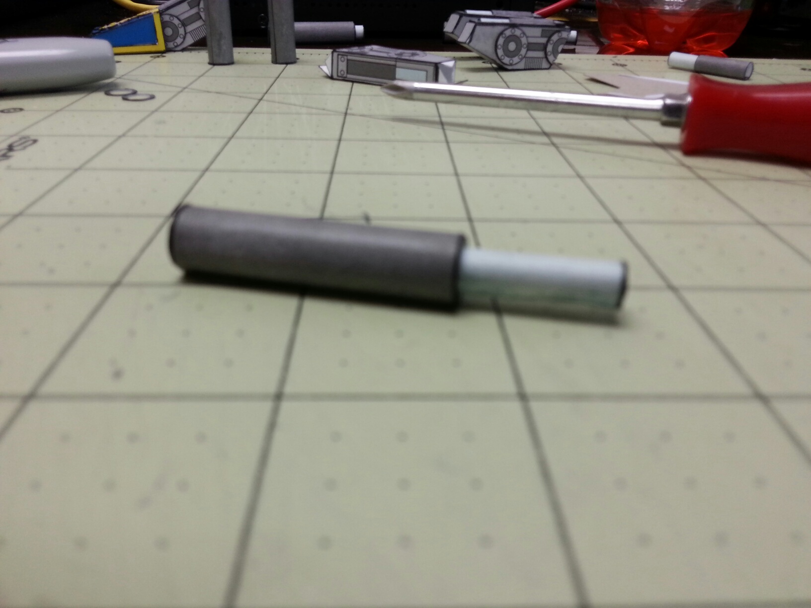

OK, so on to some pics. (This is really a guide on how to assemble the joint)
So the first thing I did was to design the whole thing in 3ds max. It involved an outer holder and a lower insert. Here is the beginning of the holder. It is an outer casing, a cap, in inside casing and some corrugation material. The load of the weapon should pull against the outer casing and the glue that attaches it to the top. Since this is perhaps the greatest load here, I glued that zig zaggy thing into the cap to make it fairly solid.

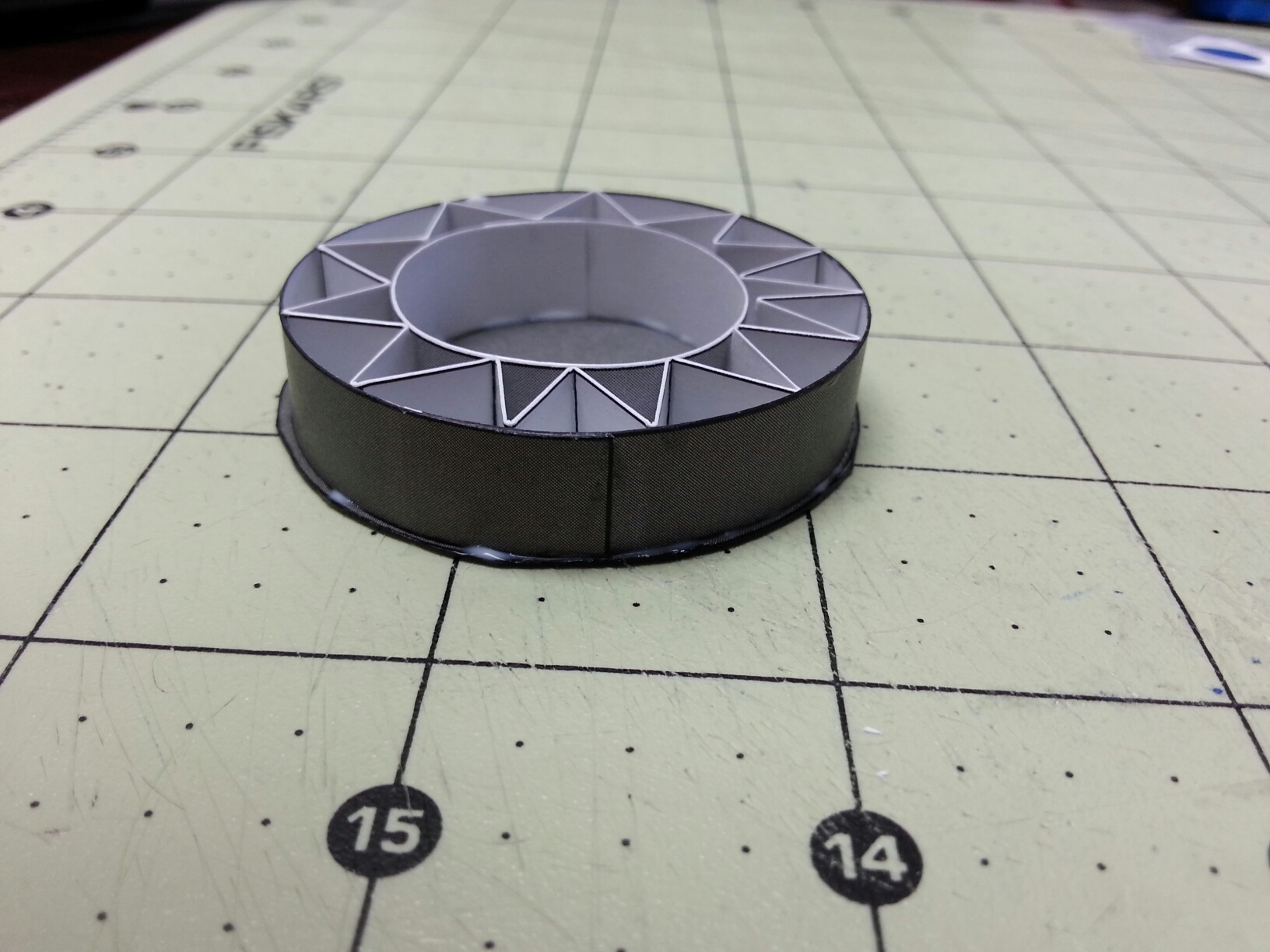

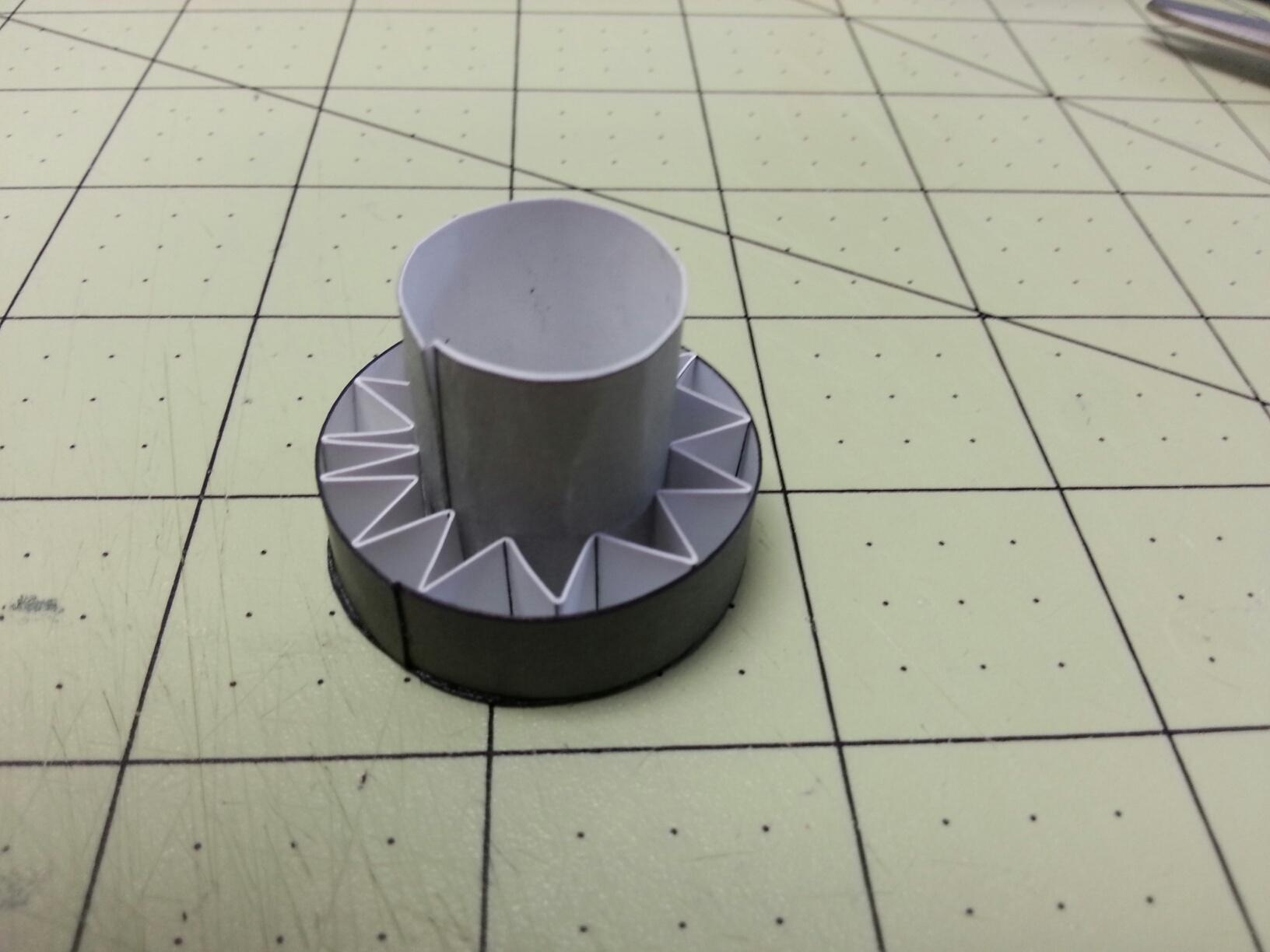

Next, I put a cap on the inside of the upper sleeve. once completely glued, that sucker won't move. The corrugation will keep the whole upper part in place.

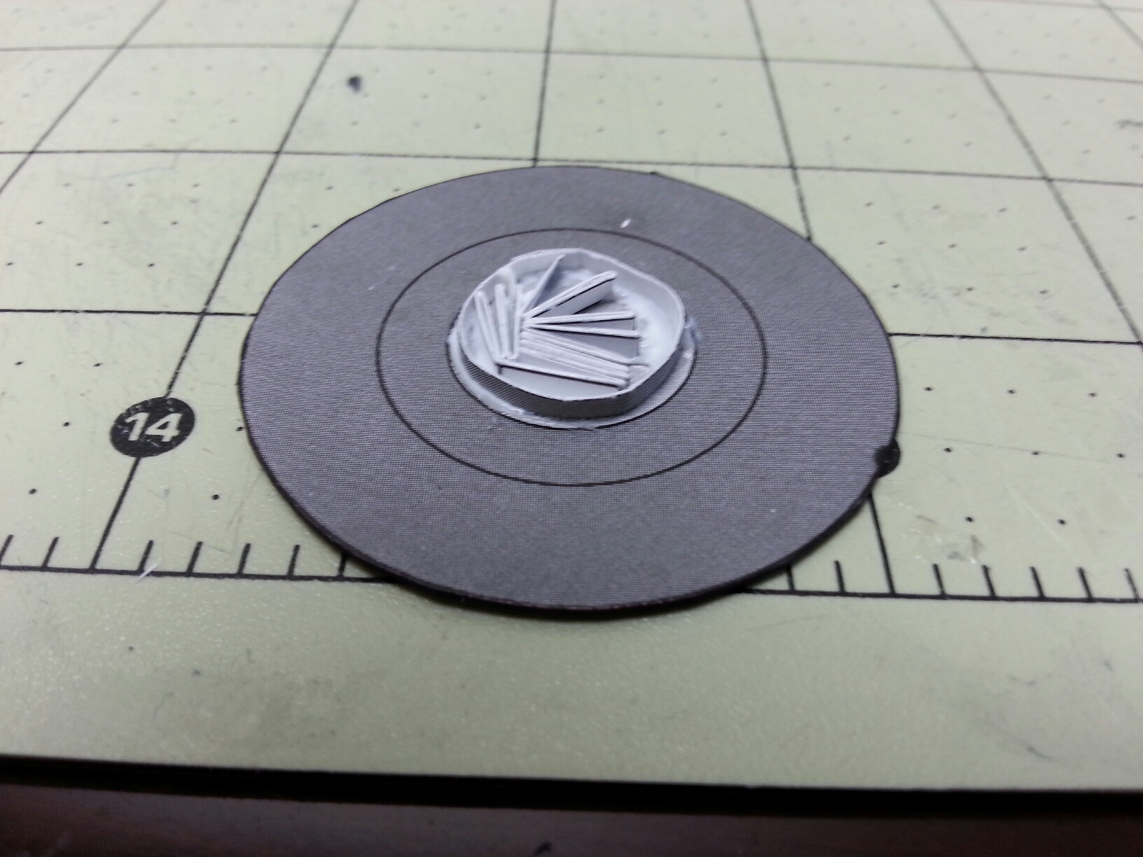

Now I am starting to work on the joint that sits inside of it.the same corrugation is applied here, but the sleeves are reversed. (it will all make sense in a bit)
Now, I build the other side. using the same as above. This will create a yo yo. I put the top of the second part on before I built it.

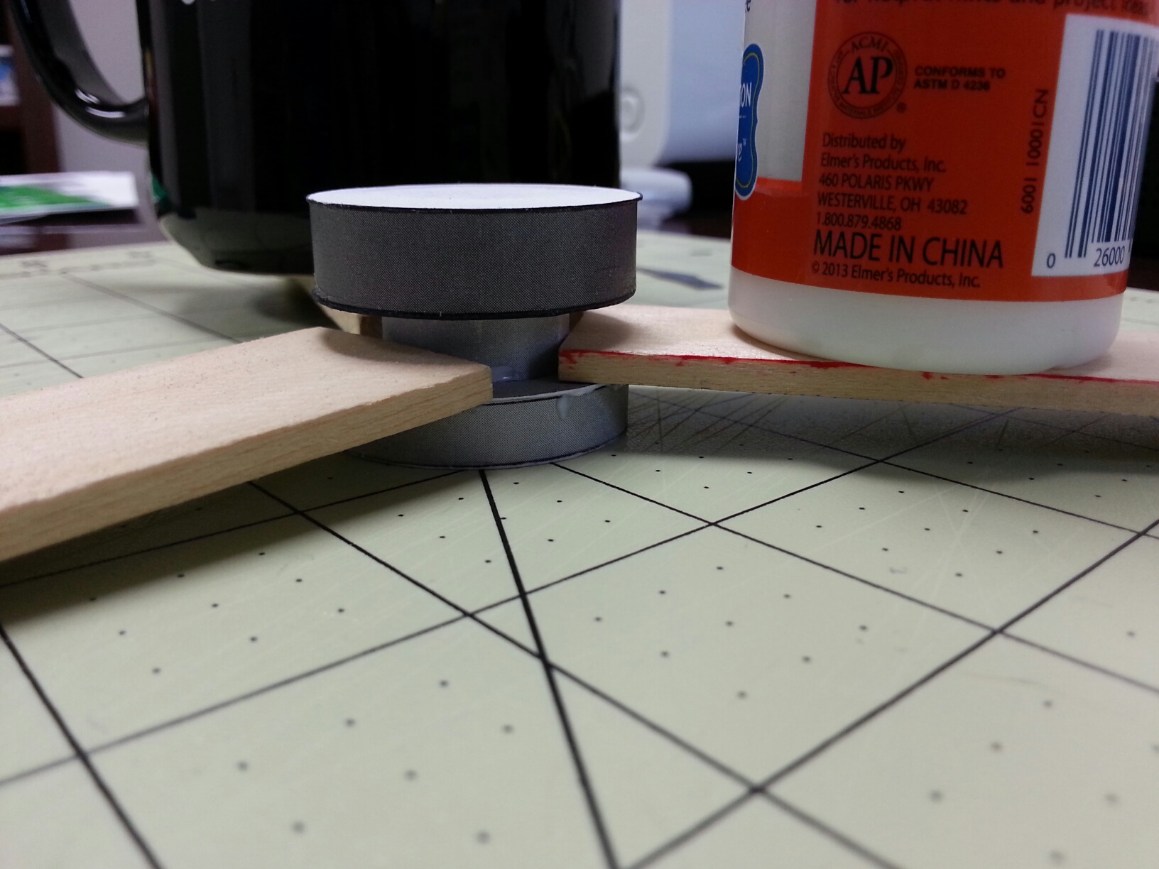

Glue and pressure... gotta have pressure.

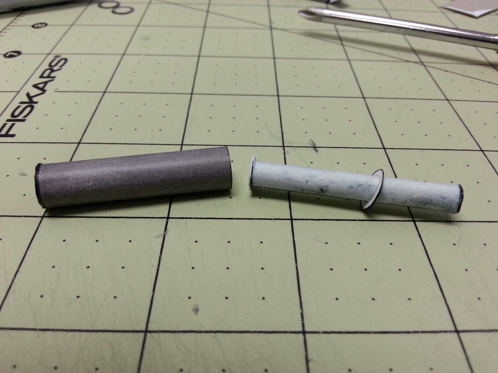

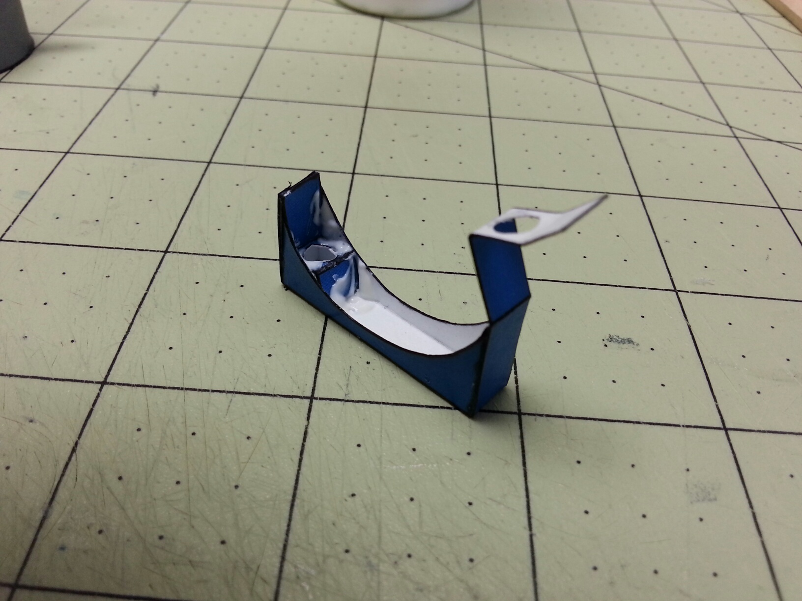

Now, I am building the pins that hold this all in place. This small piece will be the part that you pull out to release the joint. (it will allow you to change weapons on the titan)
And finally the completed joint. It is very tight. The pin head is reinforced to make sure it can handle some wear of taking it in and out. I may revisit it at a later date.
Imagine that the top is glued to the shoulder and the bottom is glued to a weapon. It rotates freely though.
In the end I had to extend the holes in the back so that I didn't have to fidget with it to get it to slide in.

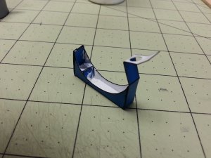

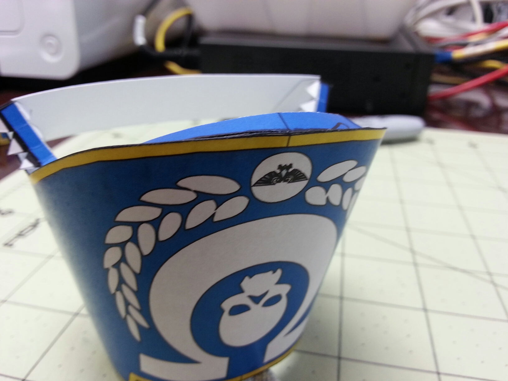

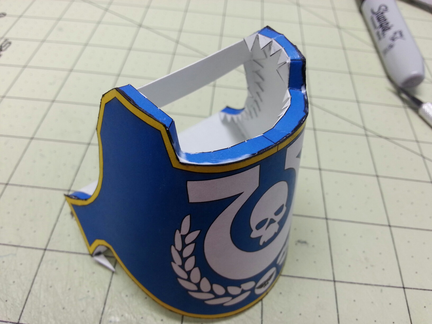

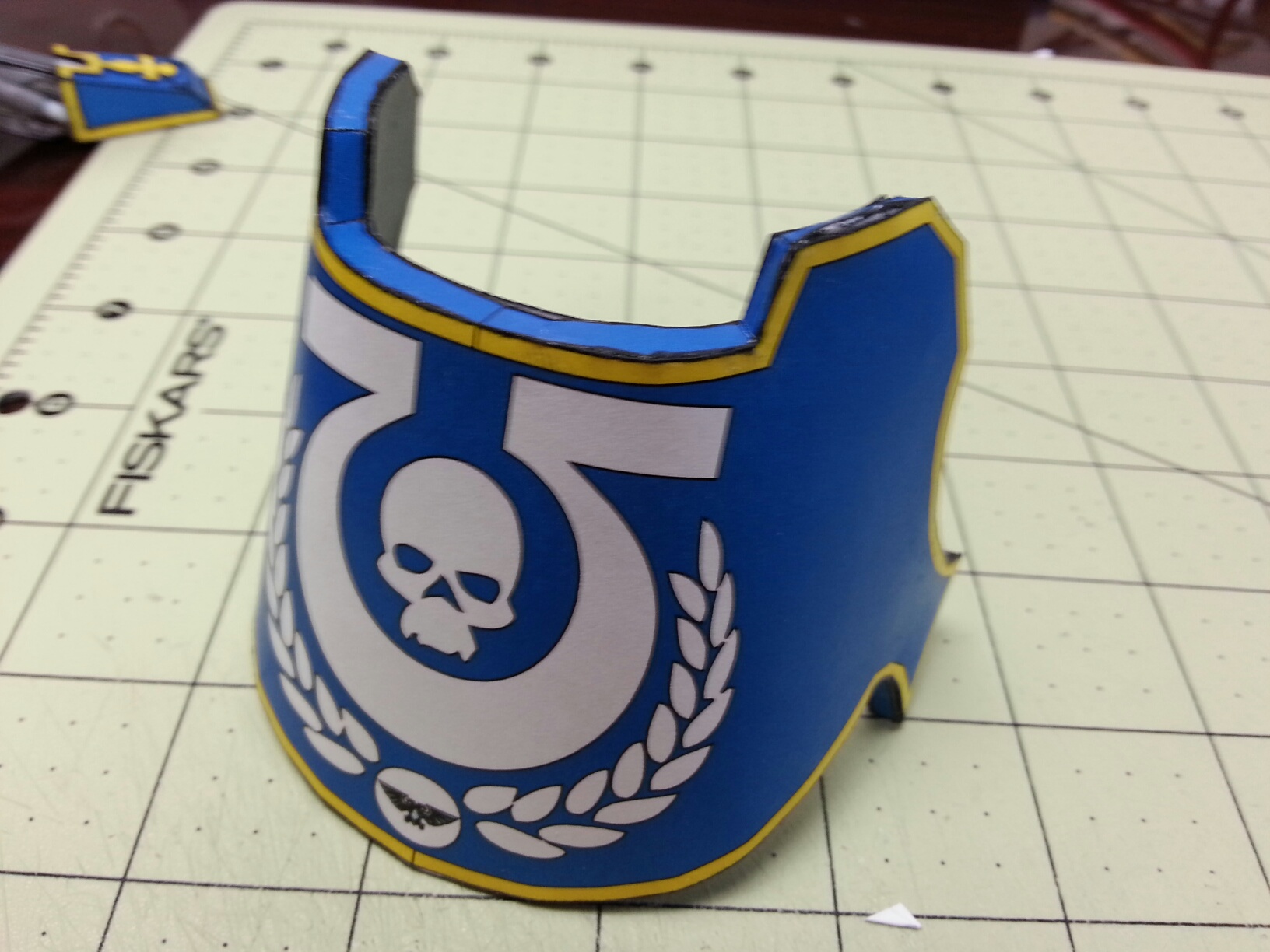

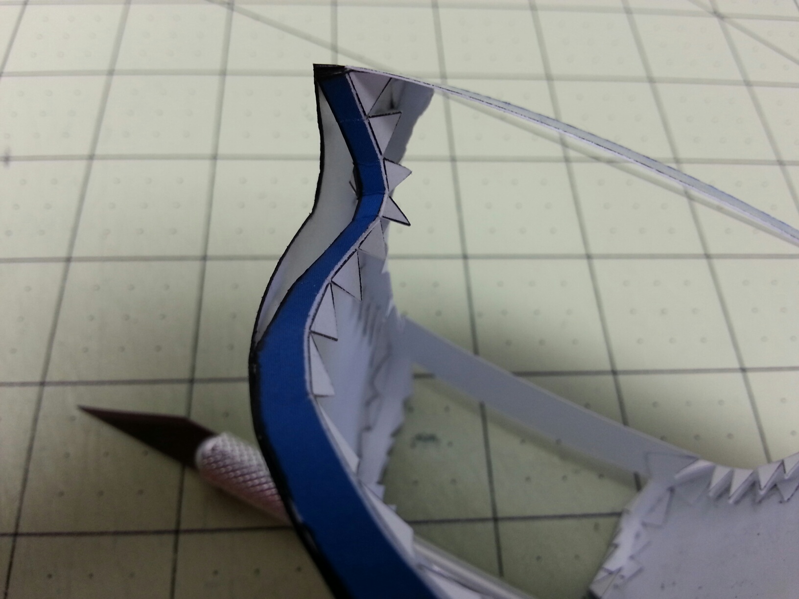

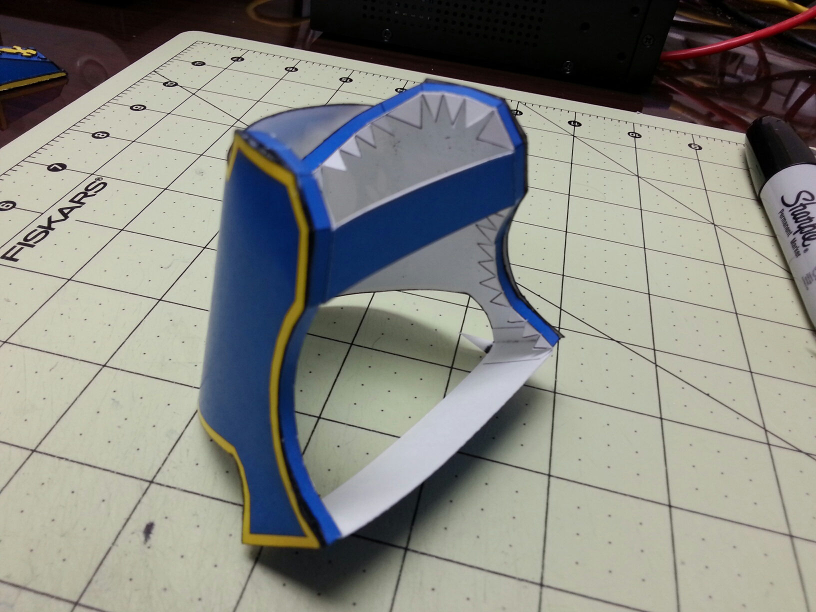

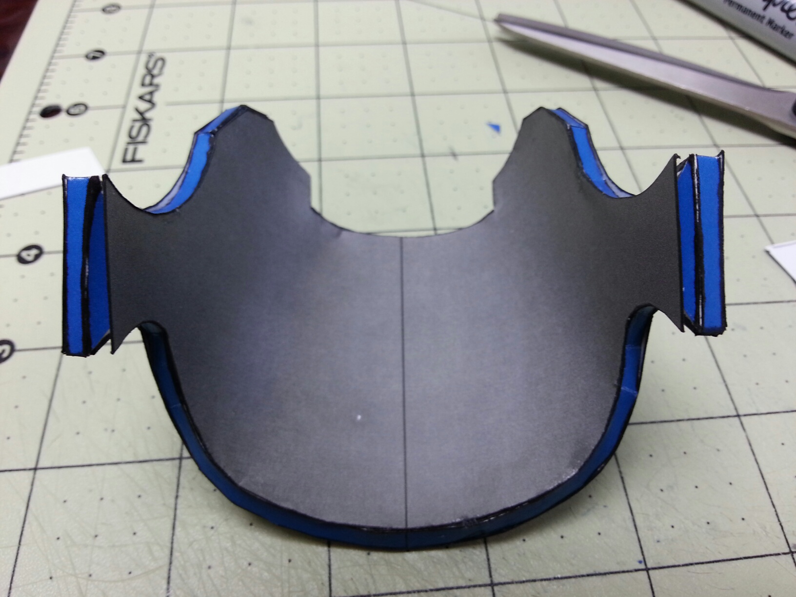

Today (actually yesterday) I got to work on my shin guards for my titan. The original ones followed an older titan and didn't look very impressive. So I went into max and tinkered around until I found something that was pretty cool. Printed it out and tested it... WRONG.... so I made some changes... WRONG.. then some more.... WRONG.... OMG I wasted paper on this.
So to make a long story short, I finally got the concept working and everything seemed to be working fine. As I was doing tests I realized that there wasn't any connection between the two sides, so I also included a connection between them, so that as it set, it would hold a bit better. (the first ones where very skewed) With the amount of gluing and waiting time it takes to make this, I had to add marks and tabs to help with alignment.

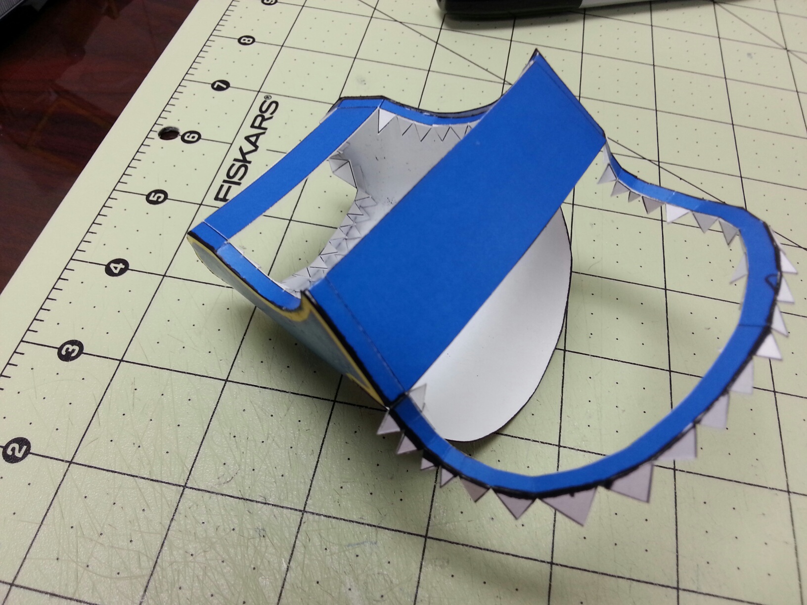

Pics of the process: (again, kind of an instructional about how to assemble this)

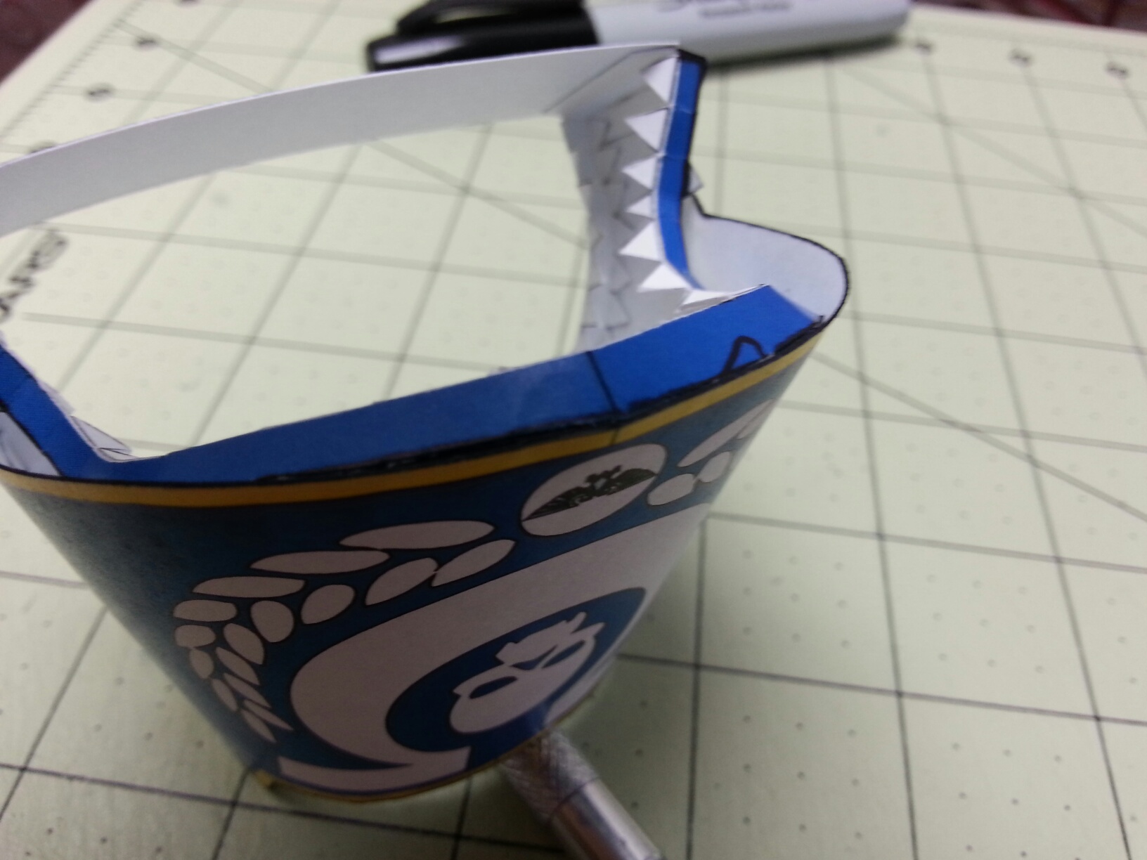

First, I glued the braced side for the farthest point on my sides and glued the brace together. This way, I could see the shape as I was working on it. (Do remember, that I bent all of the teeth in this and black lined it so I wouldn't be too messy later. I also wrapped the whole guard, so I got a predictable shape. To do this, I simply used the curved part of my desk and pulled it back and forth across it. This warped the paper and gave it shape.)
Next, I glued the next tab section into place while curving the part that goes up to it. I also glued that brace to set the shape. I then proceeded to glue the curve between them, then started on the upper section. You can see in the picture that the front teeth and parts are pushed into the model. This is so that the teeth quit grabbing the front. It is very hard to glue stuff when it is pushing against what you are trying to glue. It is important to note that the front vertical piece (the one that leads to the front) is not glued. This is so that I can maneuver the front into place for gluing. If I glued it, the next part would be next to impossible.
Now, I glued the front center and matched the mark for alignment. I actually only glued the first 2 teeth. This way It gets the center but I don't have to mess with trying to keep everything level at this point. 2 teeth at a time, I glue and level them until I have them all done. With the last teeth on each side, I also glue the upper piece that I did not glue earlier. (You can see excessive glue on the model. It is white glue that dries clear.) The problem I encountered on this was that the pieces were very hard to keep edge to edge. In the end, that was not hugely important. Black marker fixes anything... LOL)
OK, the next part is the bottom side of the guard. I glued the two ends onto the bottom teeth of the other, then glued the center mark. (4 teeth glued)
Next, 2-3 teeth at a time, I glued and leveled it until I reached the back part. Again, if the back part is not perfect, that is ok. we can hide it. It should be very close though.
So with all of this, now I let it sit for about 10 minutes so that the glue can become hard. The next step will start to remove the braces. I also take the time to use a marker to black line the back since now it is much sturdier than when it was all apart.

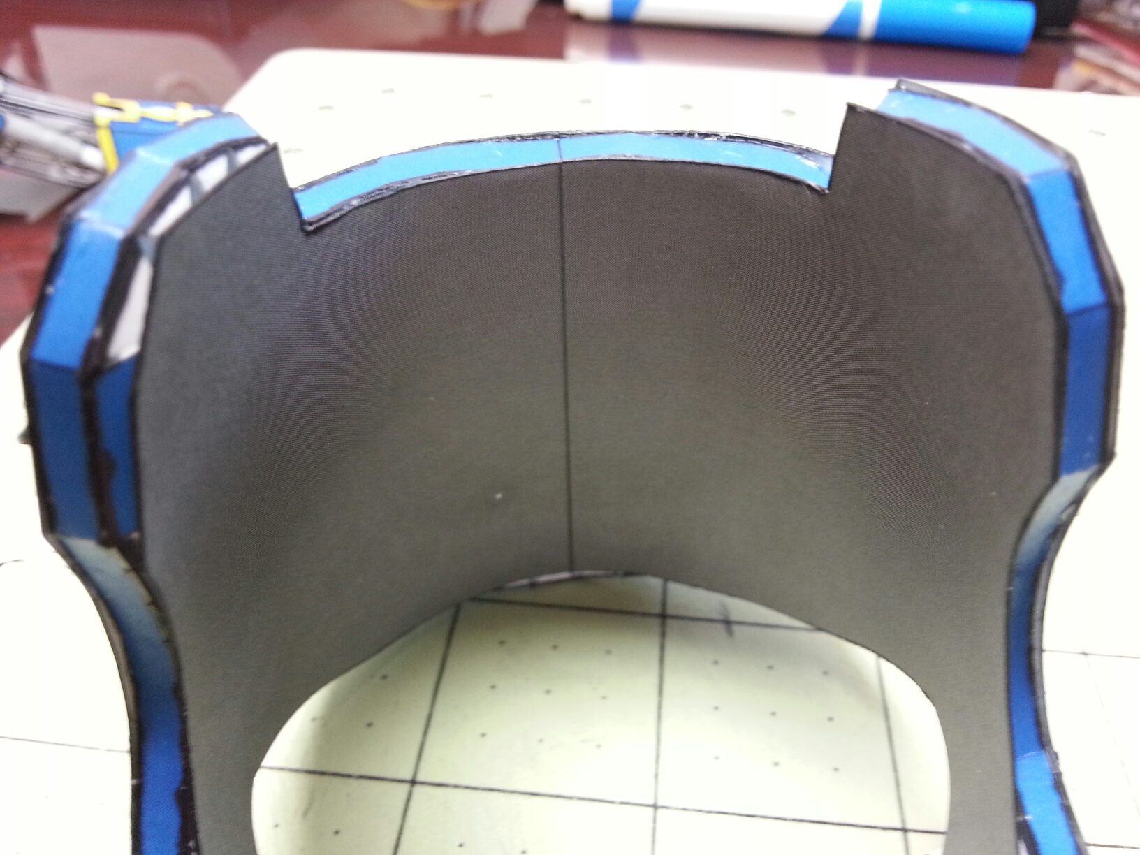

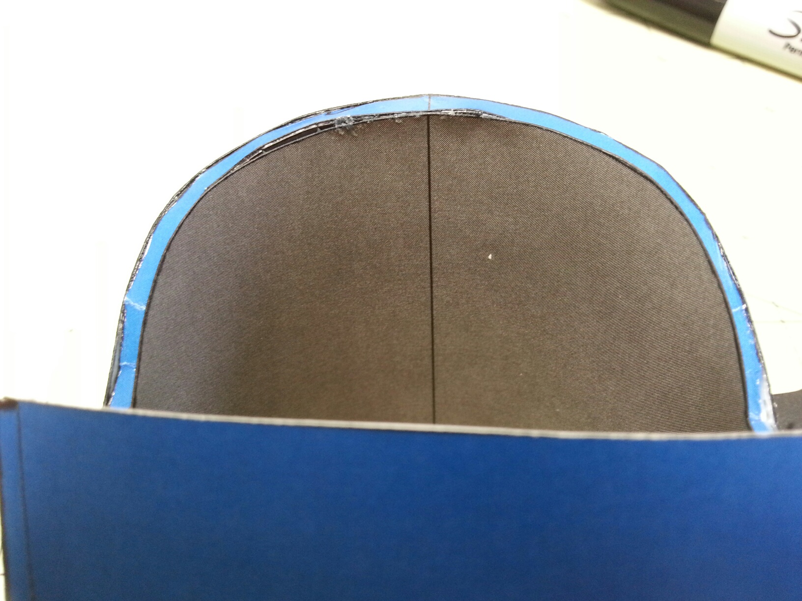

Now, onto the back. I warp it so that it fits into the area. and remove the upper brace. (I cut it with some scissors.) Now, I glue all the top teeth in the front and push the back plate into the braced bottom aligning the marks, top and trying to not get it hung up in the bottom teeth. When you press this, the sides should line up as well. Keep lots of pressure on this until that glue sets. (Remember, I am using quick drying white glue, so that is about 20-30 seconds. I hold it longer. (If this comes unglued for any reason, it is going to be a pain to fix.)
Next. making sure that the bottom teeth are all set in place, I glue about 4 of them and center the bottom mark. I now have the top and a few of the bottom in place
Now, I start gluing until I am an inch or so away from the bottom brace on all 4 parts. Again, I wait 10 minutes before I cut that brace so the glue has time to set. I cut the brace at an angle so that it folds correctly into the bottom part. Fold it, black line it and I glue the last of them together. At this point, I pay attention to any skewing that happens as I glue this. Try to make them straight with the rest of the model.
Tada... finished. You will see this on the model in later pics. When I put it on it and glued it I got a warm fuzzy feeling, then realized that I forgot to pee during all of this....

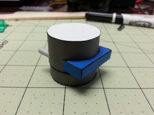

Let me start off with the waist joint. As per the shoulder joints, this one had to move. and even better it had to be able to be disconnected. At first, I thought it was going to be this big joint that I could mimic from the other one. Alas, that was not the case. I had about 2 inches by less than a half an inch to work with. So that ruled out the whole paper dowel I used on the other one. I could, however, use a bit of corrugation to make it a little stronger.
Some pics:

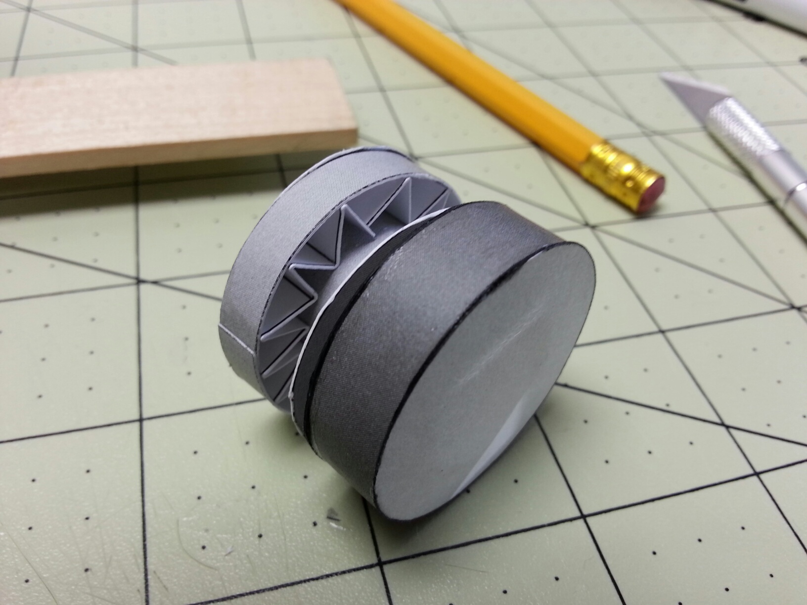

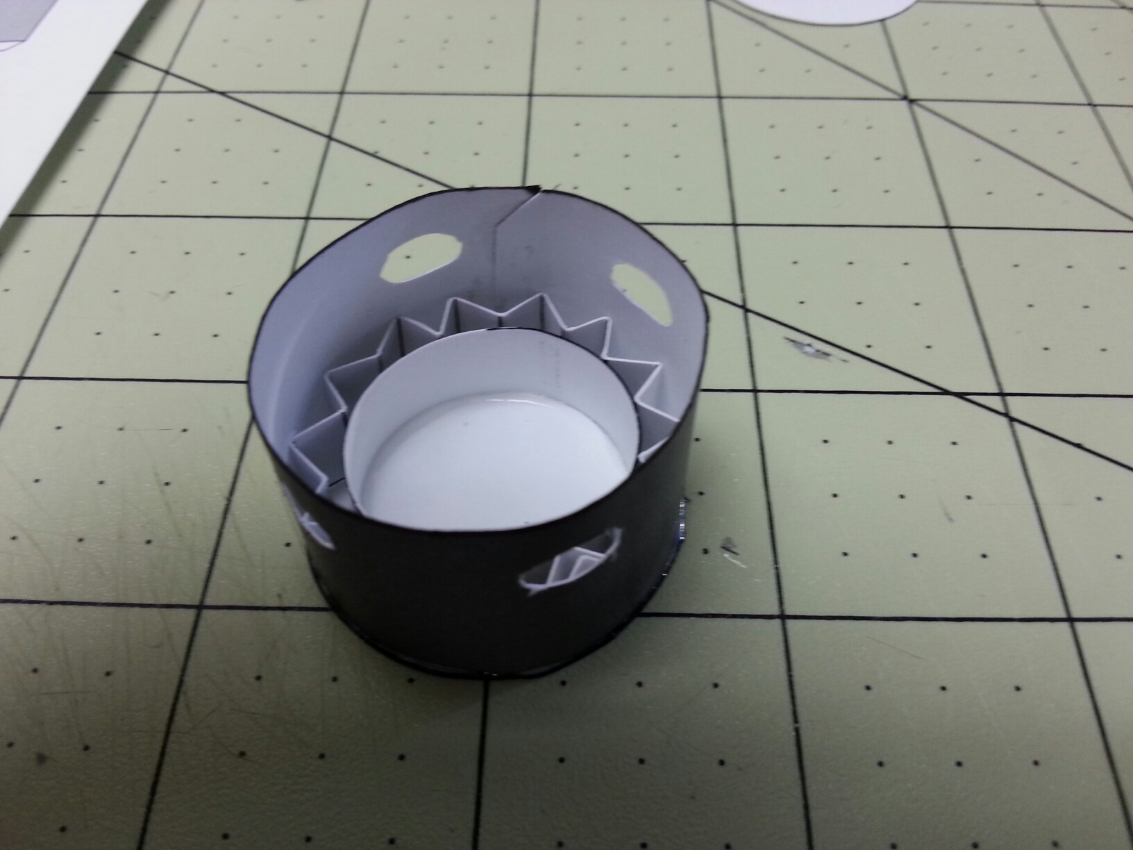

Like the other, I start off with a double tube and some support for it. It is supposed to hold all the weight of the titan's lower part, so I figured it needed some extra umph.
The upper part gets some of the same treatment. (thank god this won't be visible, it looks horrible.) Since I only have to keep it locked, then I don't need the big upper case as I had with the gun mounts.
Now, you can see the final pieces. They fit into each other and slide. If you look closely at the marks, you have to turn the top around to get it to unlock.

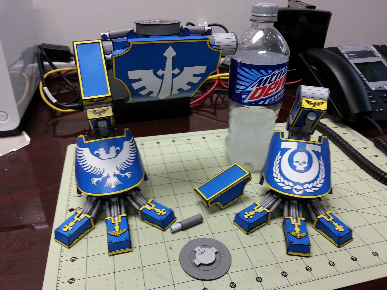

OK, this was also supposed to be in the last post. It is the finished guard on a leg.... Yes, you peed just a little too. :D
What is better than one... TWO... Not only two, but two and the cod piece.
I am about out of time today, but I can't just leave it this way. I won't have time to upload the pic of it all together, but here are all the pieces almost assembled.
(with a shameless plug for Mnt Dew....)

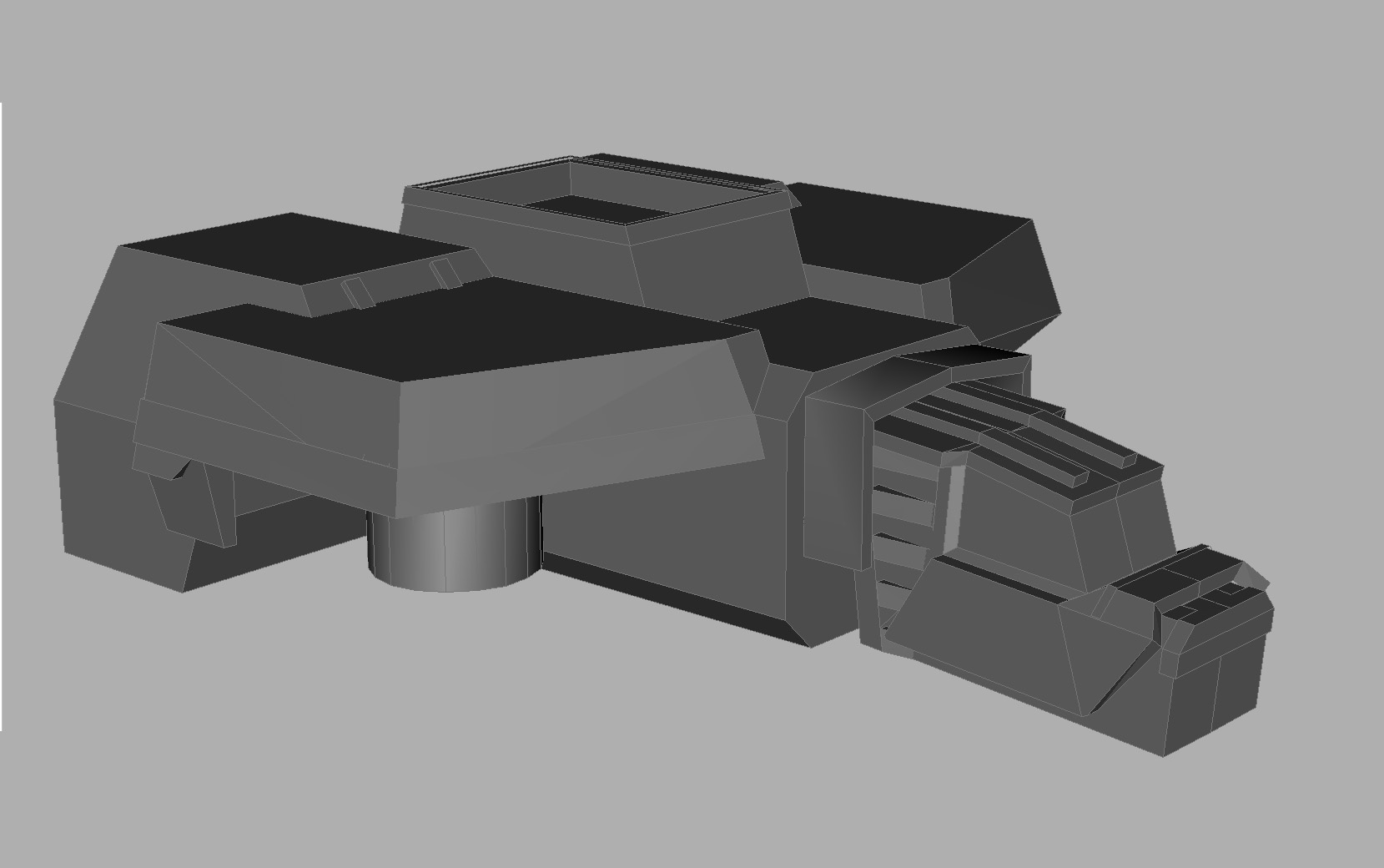

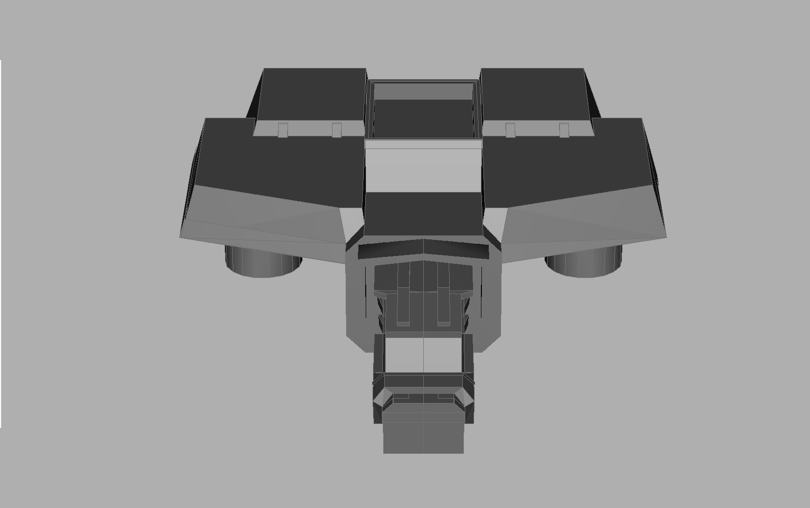

So I got to tinkering with the body components. Sadly, they just won't do. So I decided to start recreating them from scratch. This and a couple of really good pics of what this thing is supposed to be like. I figure I can do some pretty cool stuff.
Below are the first images of what it should be like. I don't know yet if I am going to redo the guns or not, I know for sure that they are going to be colored correctly though. I tried desperately to not include the sarcophagus from the movie The Chronicles of Riddick. OMG that would make this. But it really wont go with it.
Til next week.
This is all done in 3ds Max 3.1. It is nothing but a screen capture for what is on my screen. No lighting, no nothing. I will take these and move them into Pepakura, then into Illustrator and "fix" them so that they work correctly.

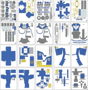

Teaser time.
Since I can't actually build today or tomorrow, I can work in 3d and illustrator and get things moving towards the final goal. I took all my 3d models and worked them through unfolding and put them into illustrator. I also started doing the decoration on it and other pieces. I really only have gotten started with this part. It will take quite a bit of work.
Attached is a "teaser" of what the overall illustrator file works out to be. 20 pages thus far, and probably a good 10 more in weapons.

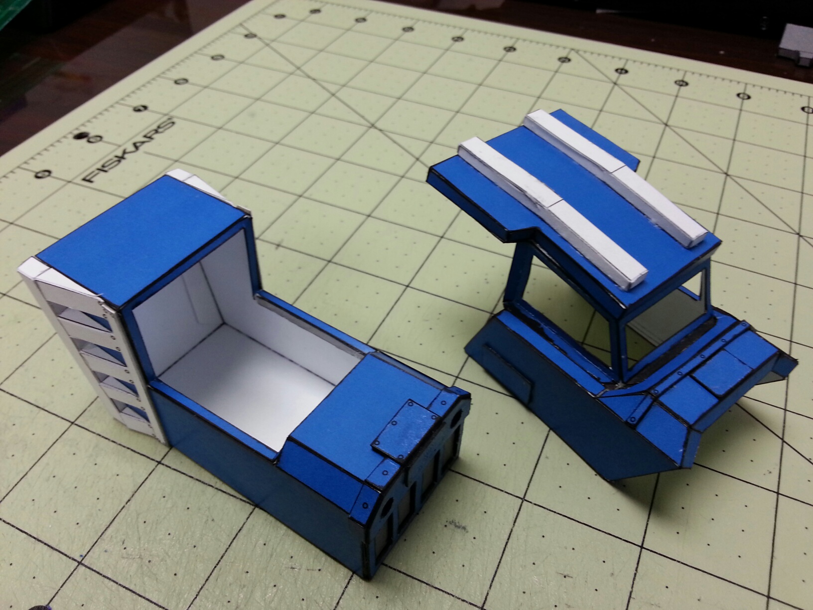

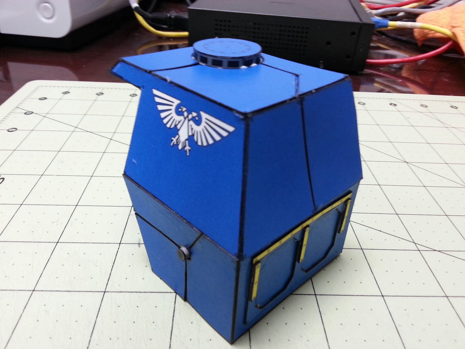

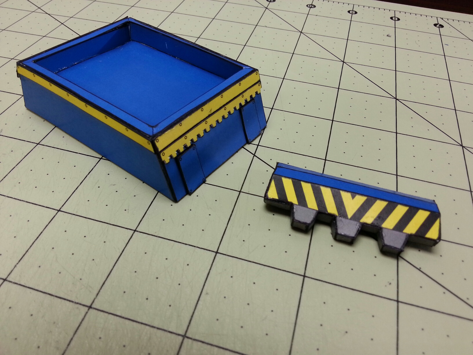

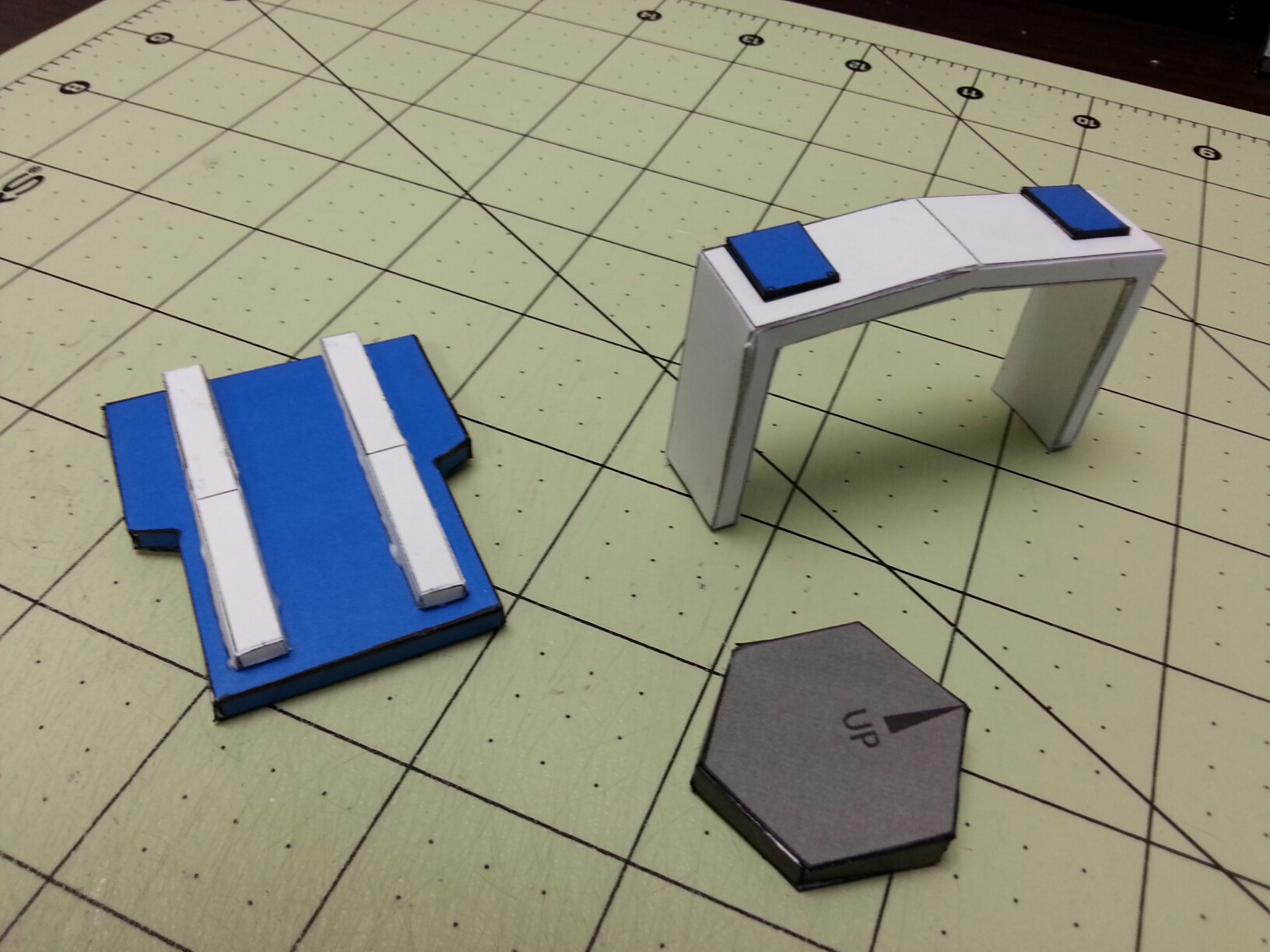

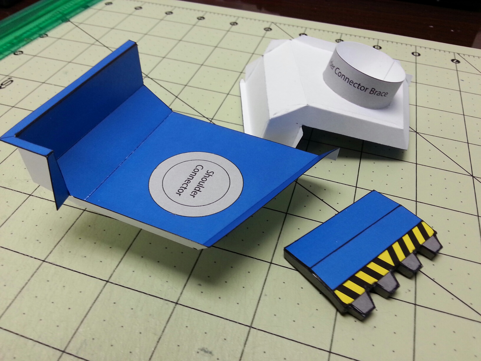

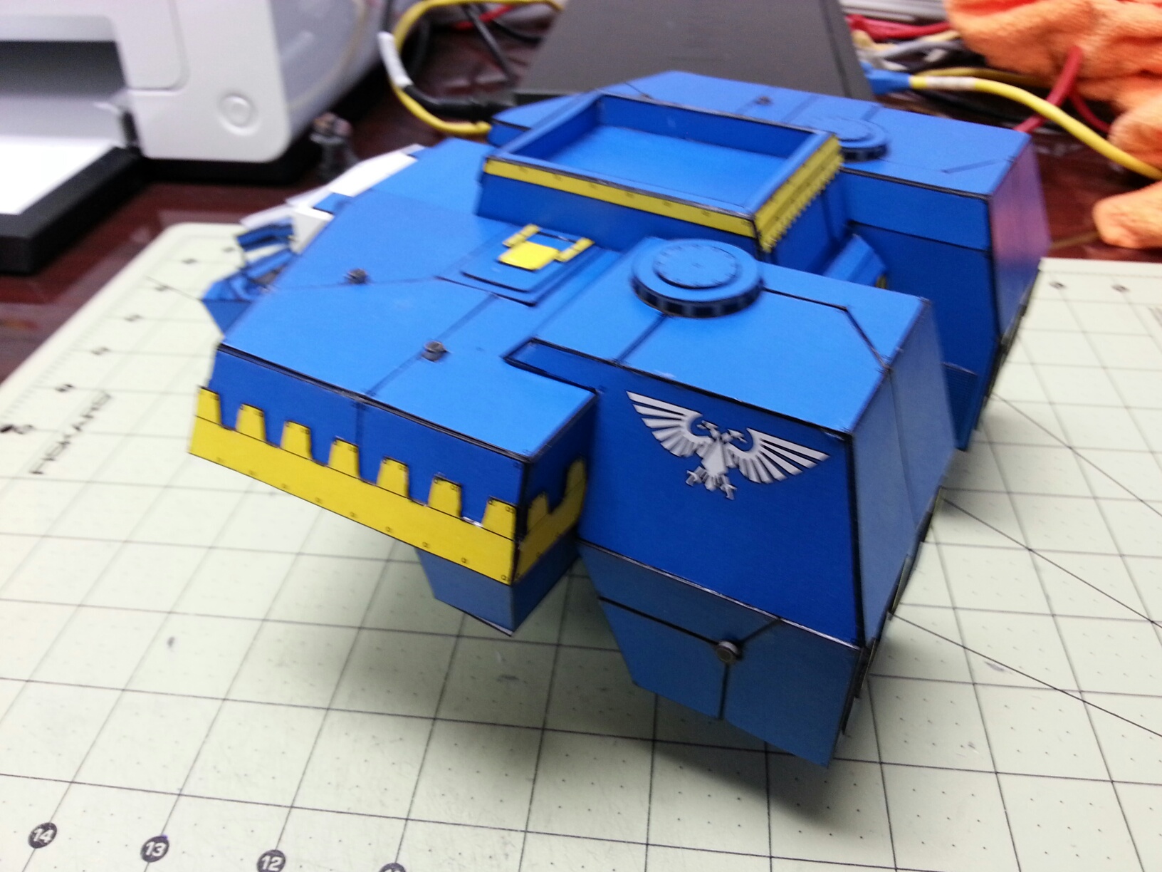

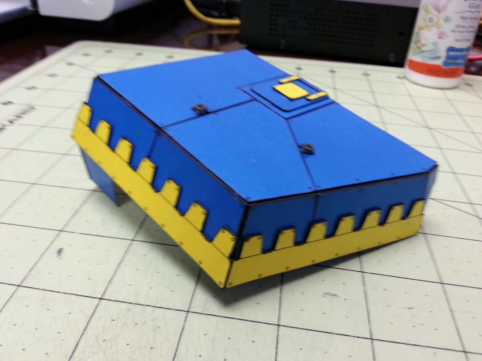

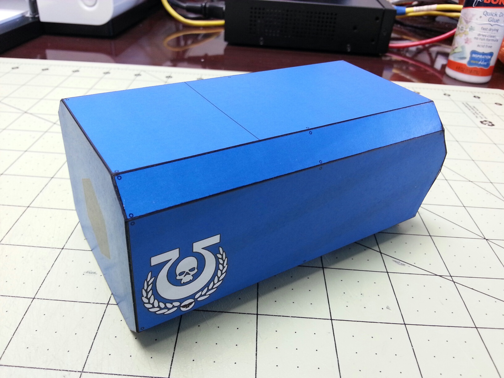

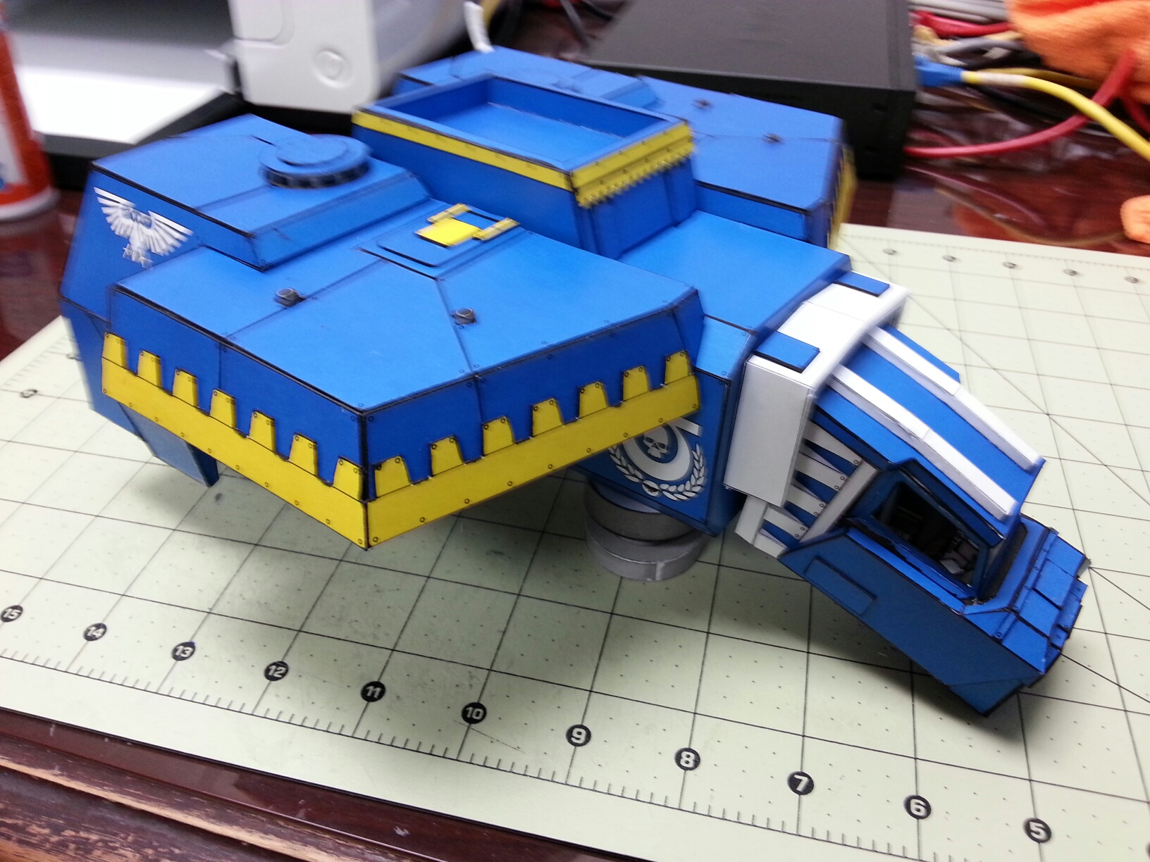

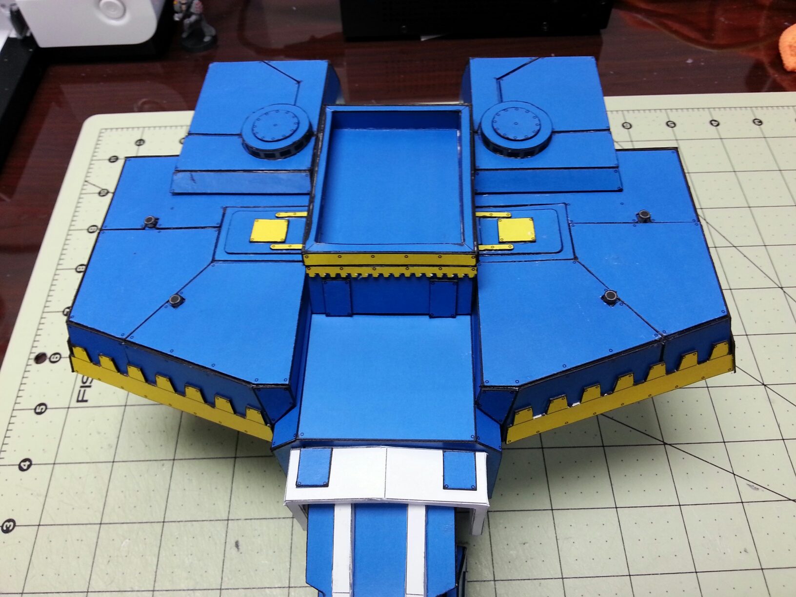

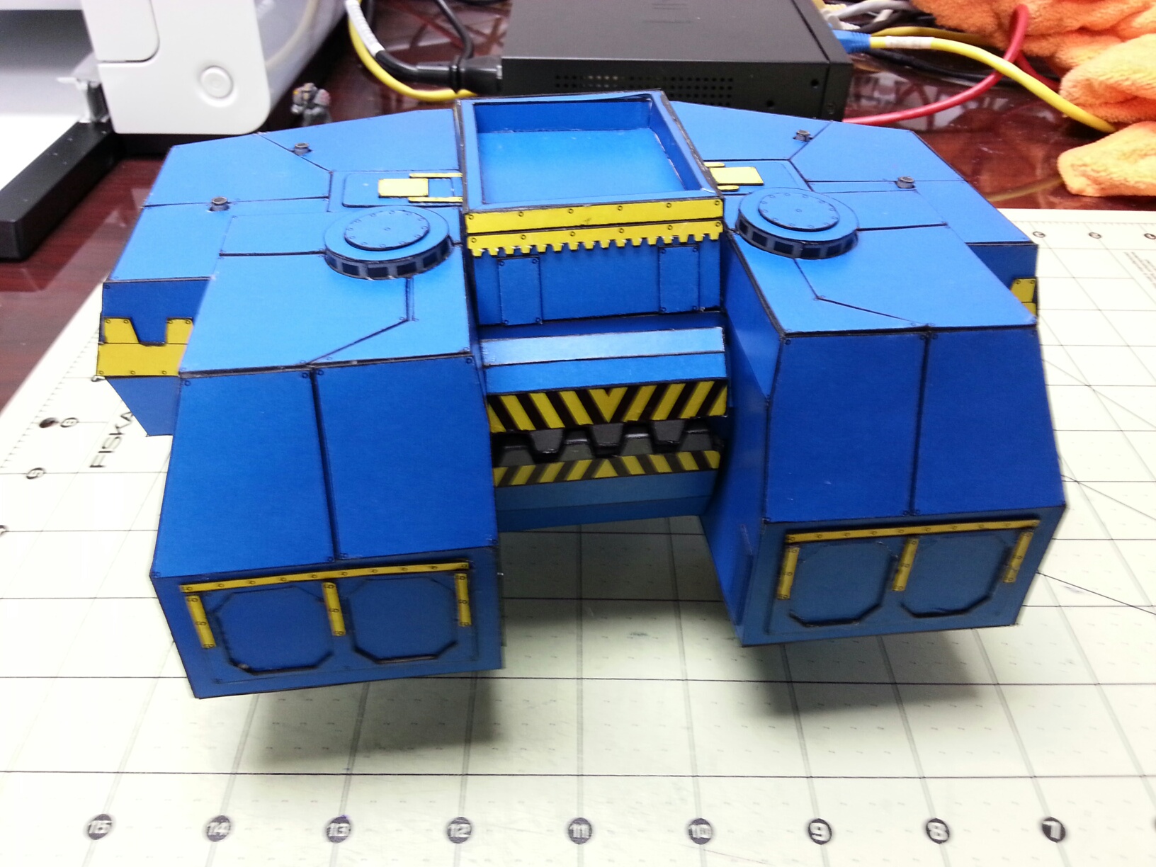

Main Hull

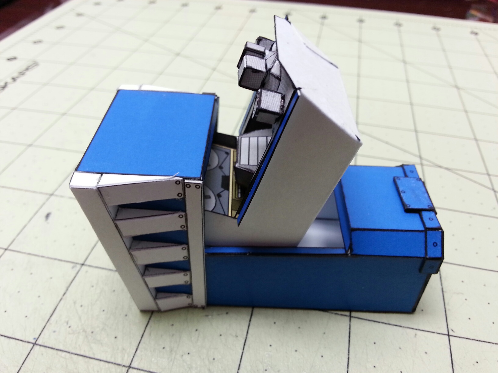

Back Cap with upper door

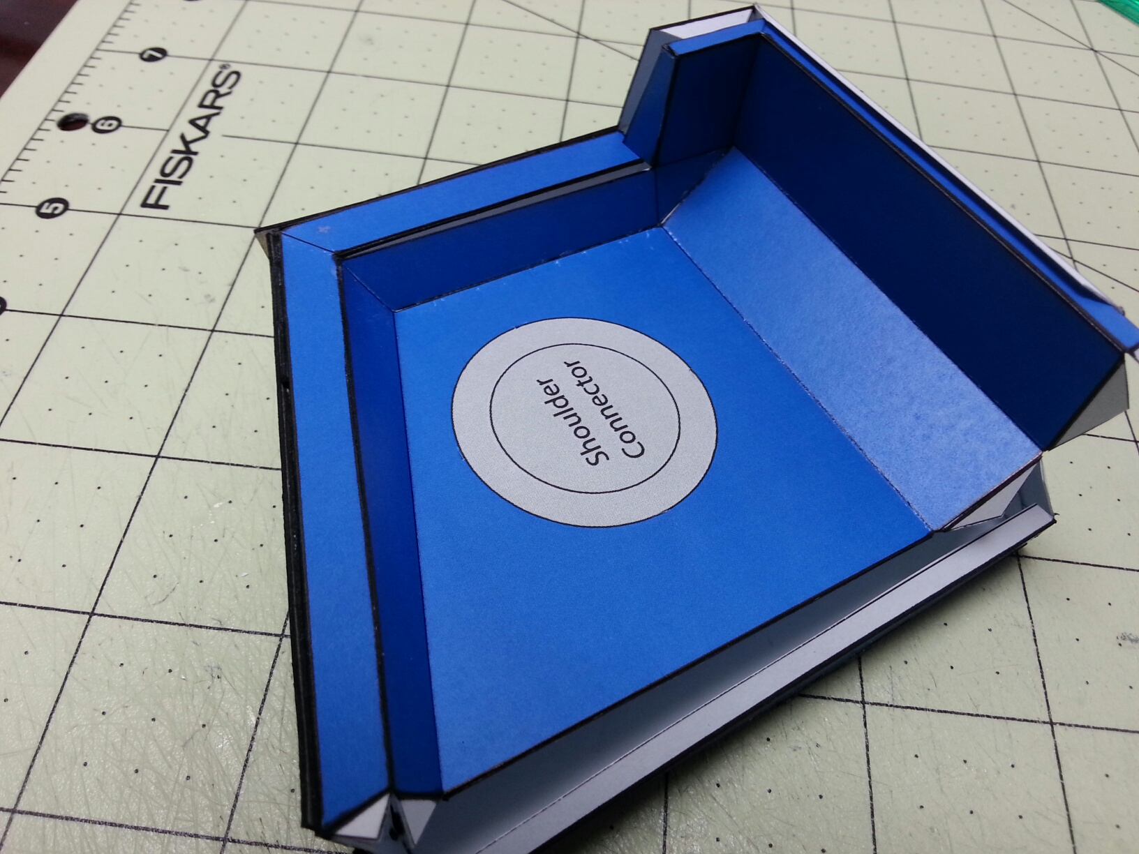

Two inner shoulder pads with lower door. There is also the spacer that helps support the weapons.
One trick I used was to puncture the inner pad in 4 places to show where the spacer should go.

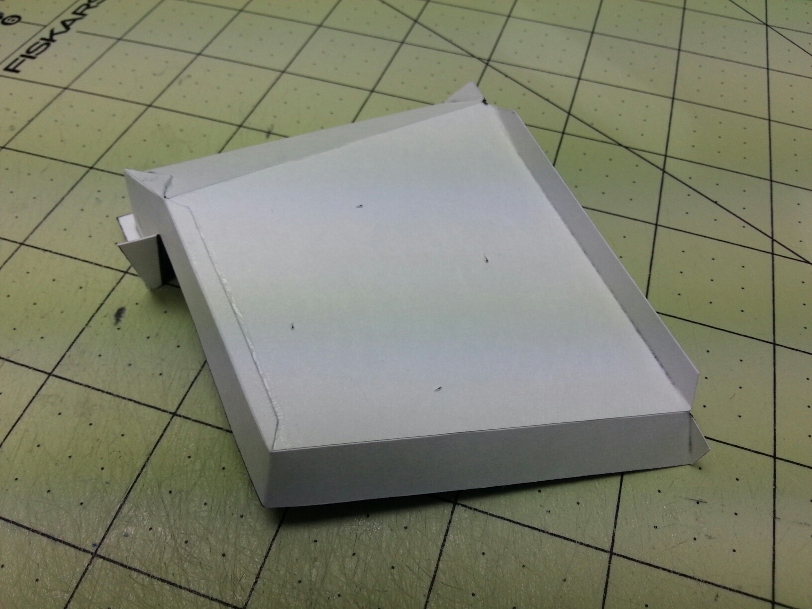

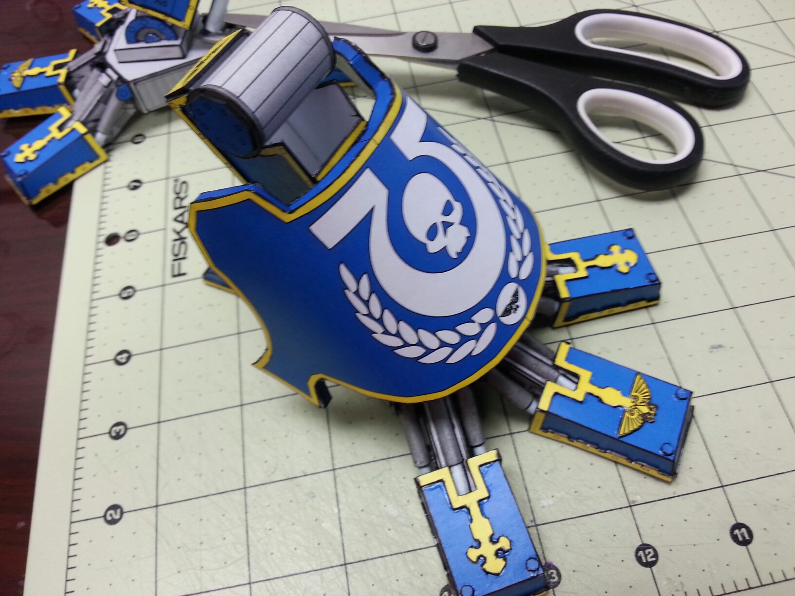

Shoulder pad. The trim is actually located on the previous page from this one as this is a big piece for each page.
In pad assembly, the first thing I did was to glue only one part of the two together, using the spacer and anything else I could to get it in the correct place. (From trying to build the original with an inner pad, this was incredibly difficult. This is actually where the inner spacer came from because it was way too hard to get them to glue and hold them without it moving all over the place.)
Back Shoulder pad.

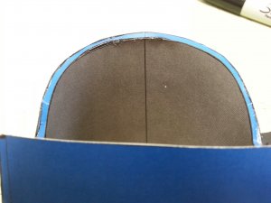

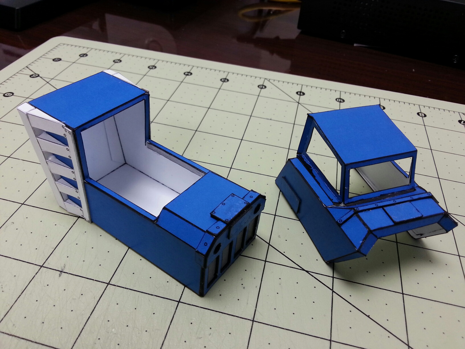

Lower jaw and cabin cover.
Collar, neck and "hat"
This is simply the hat placed on the cabin cover.
What wont be in this is the fact that I had to create a lip to hold the cabin cover onto the jaw.
And yes, because of the 10 picture limit, I am going to make you wait til next week to see the body assembled.

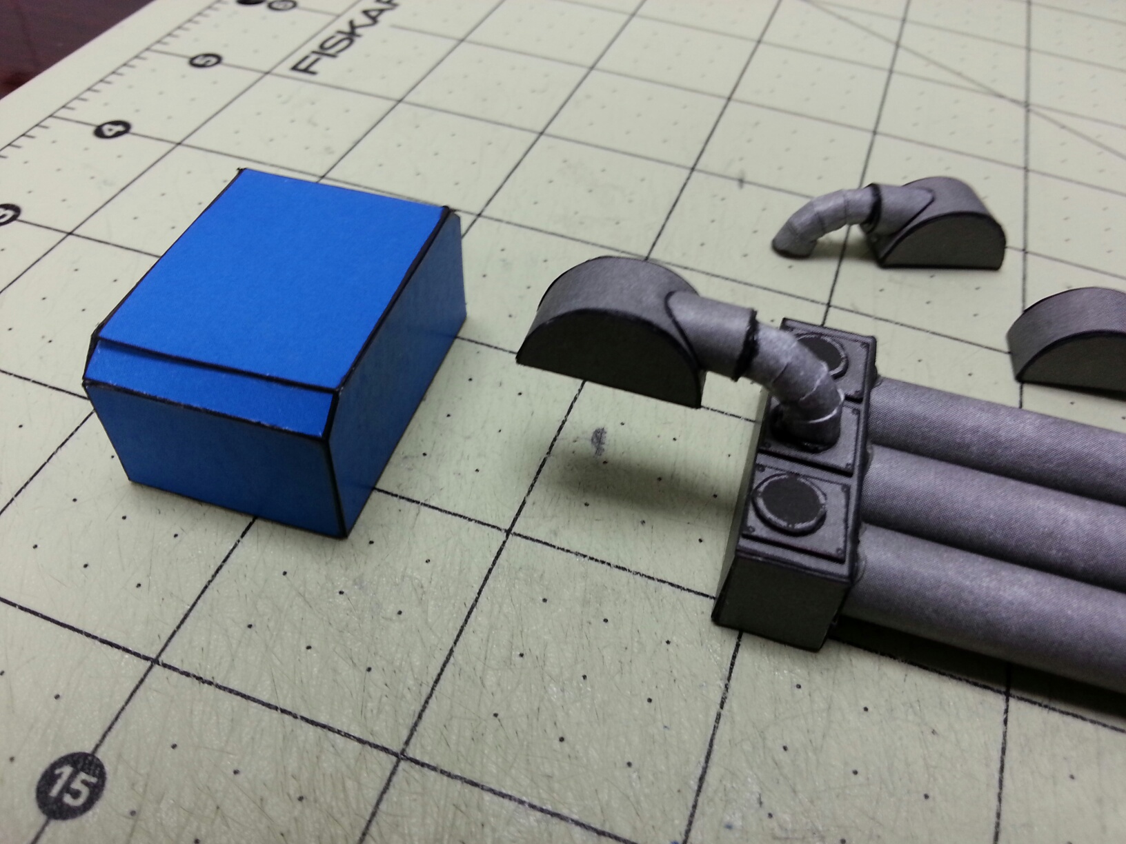

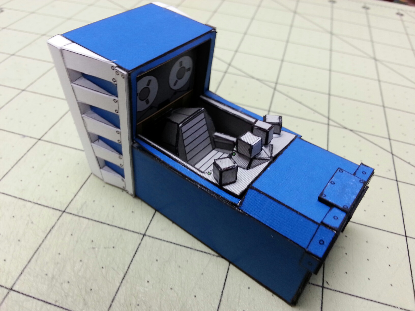

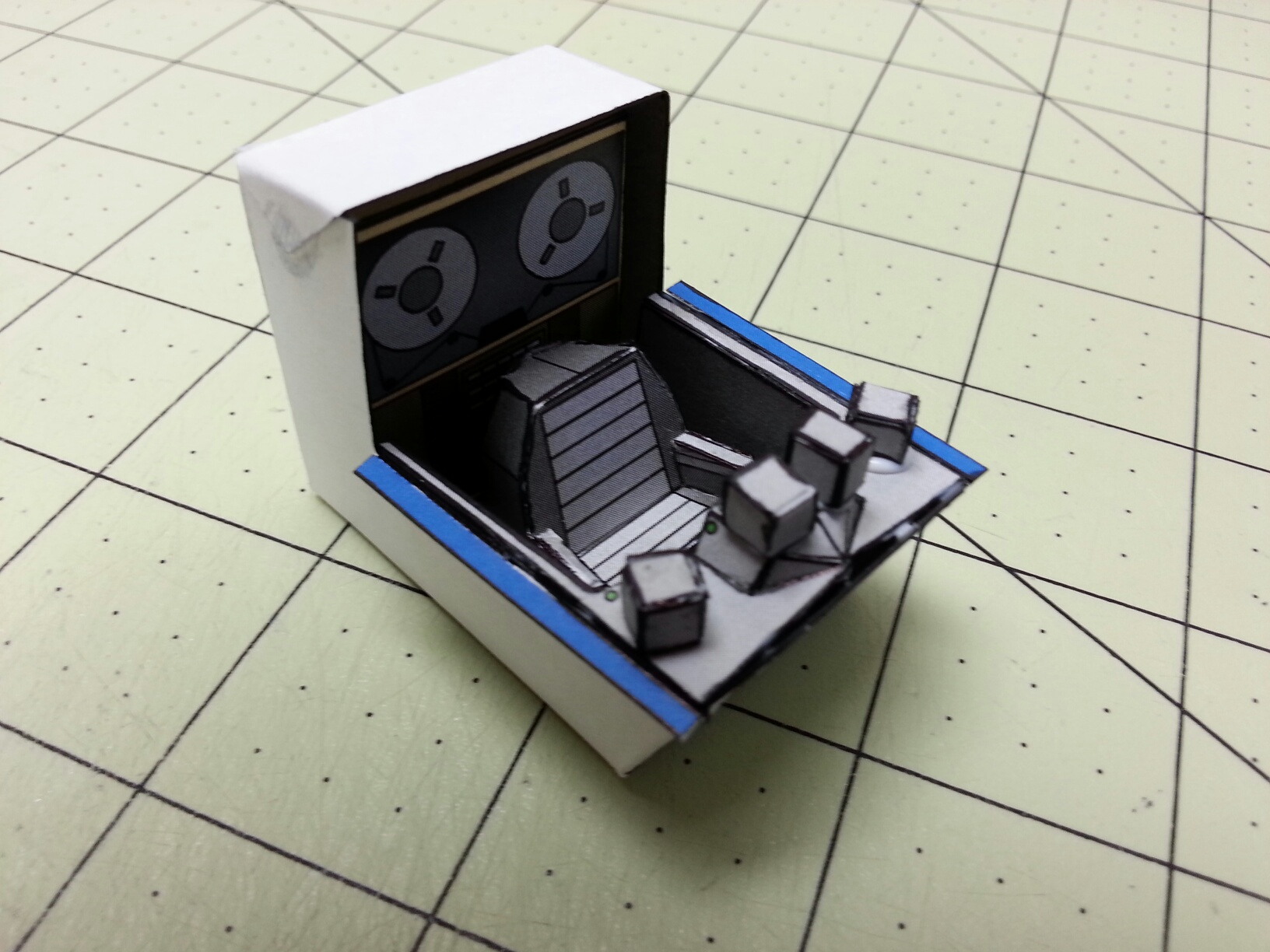

These are the parts from the cockpit page. I took the time to make them all since nothing was referenced in the original document.

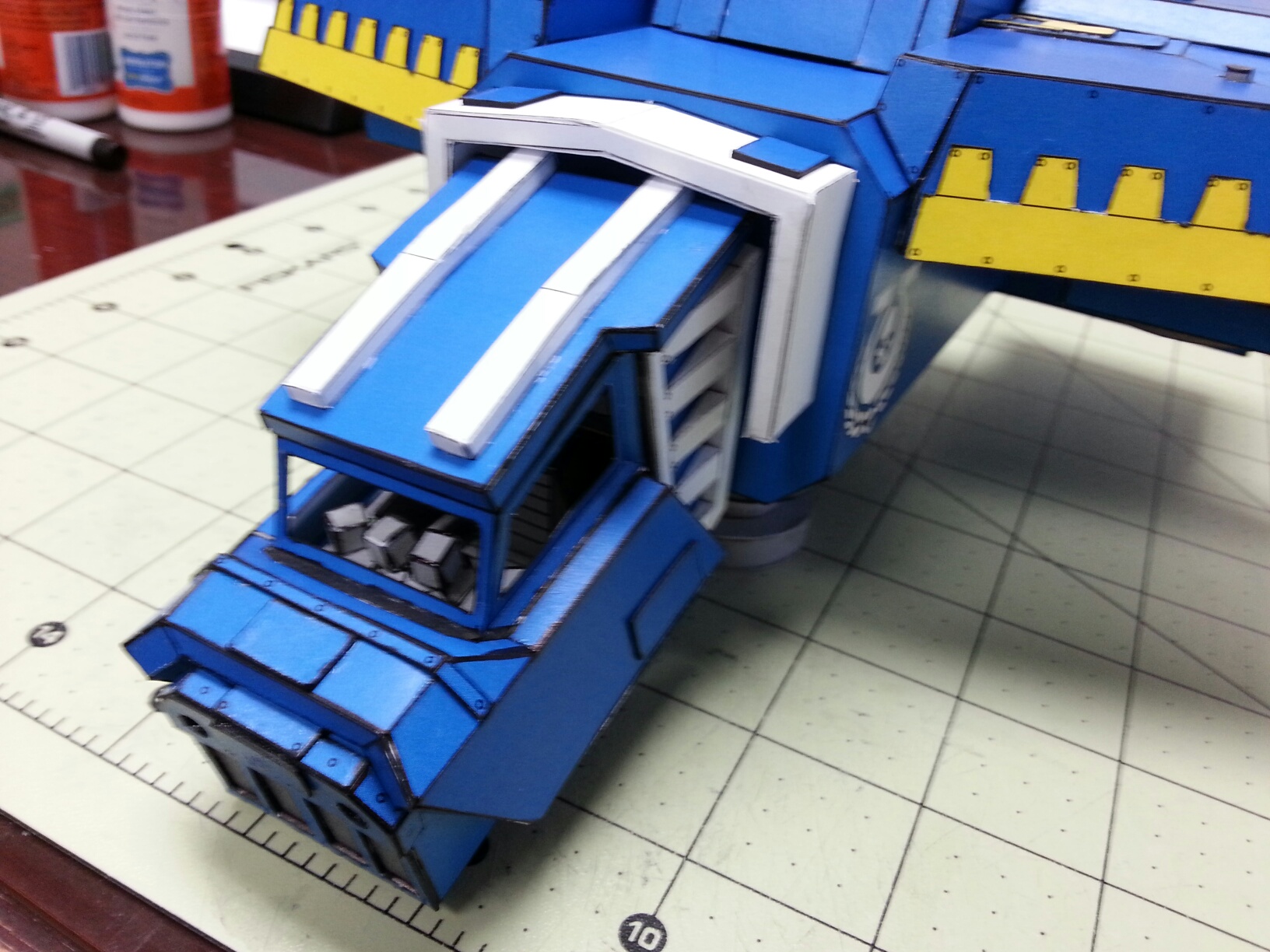

Totally Assembled cockpit.
How to insert the cockpit.
Final jaw piece with the cockpit inserted and glued.

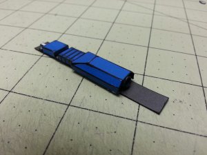

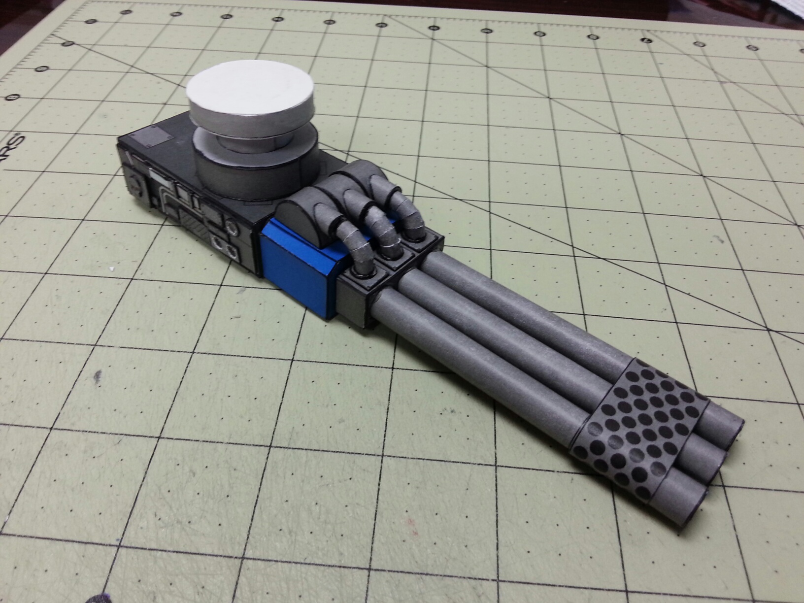

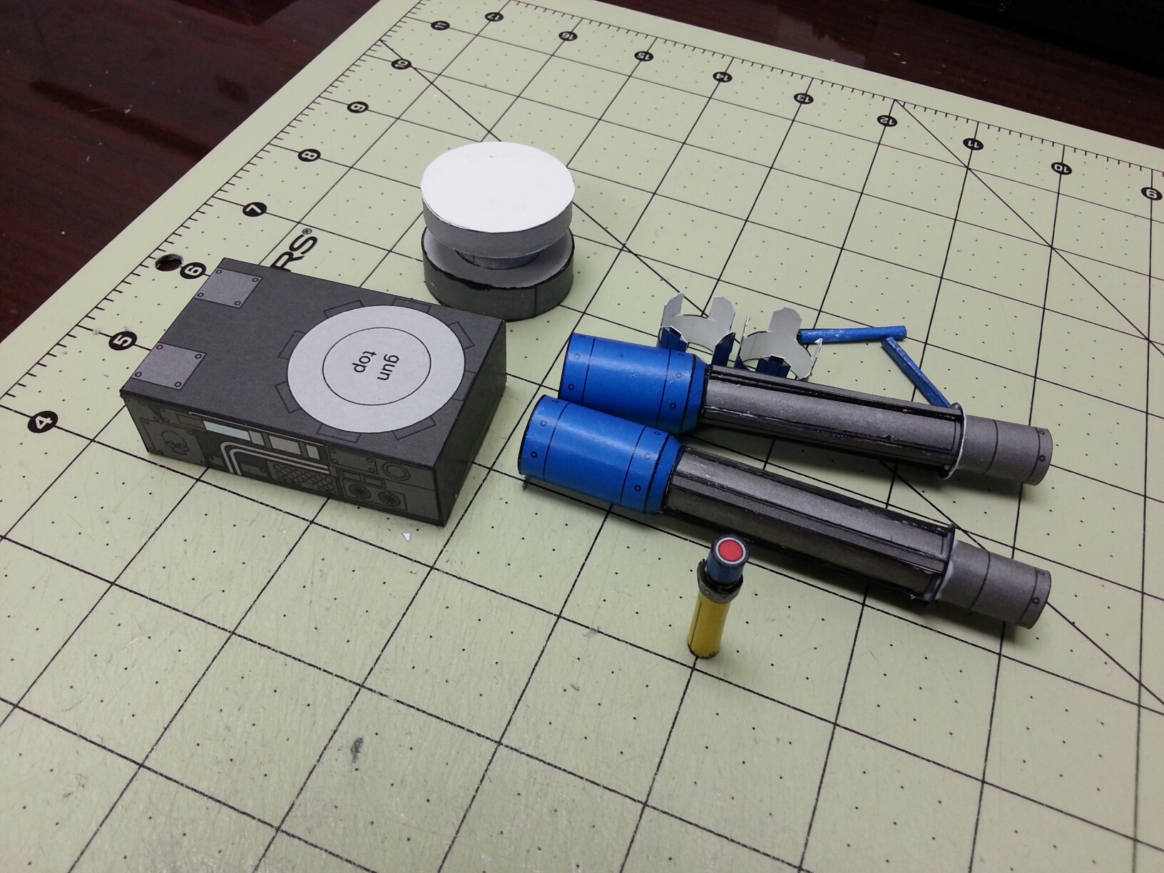

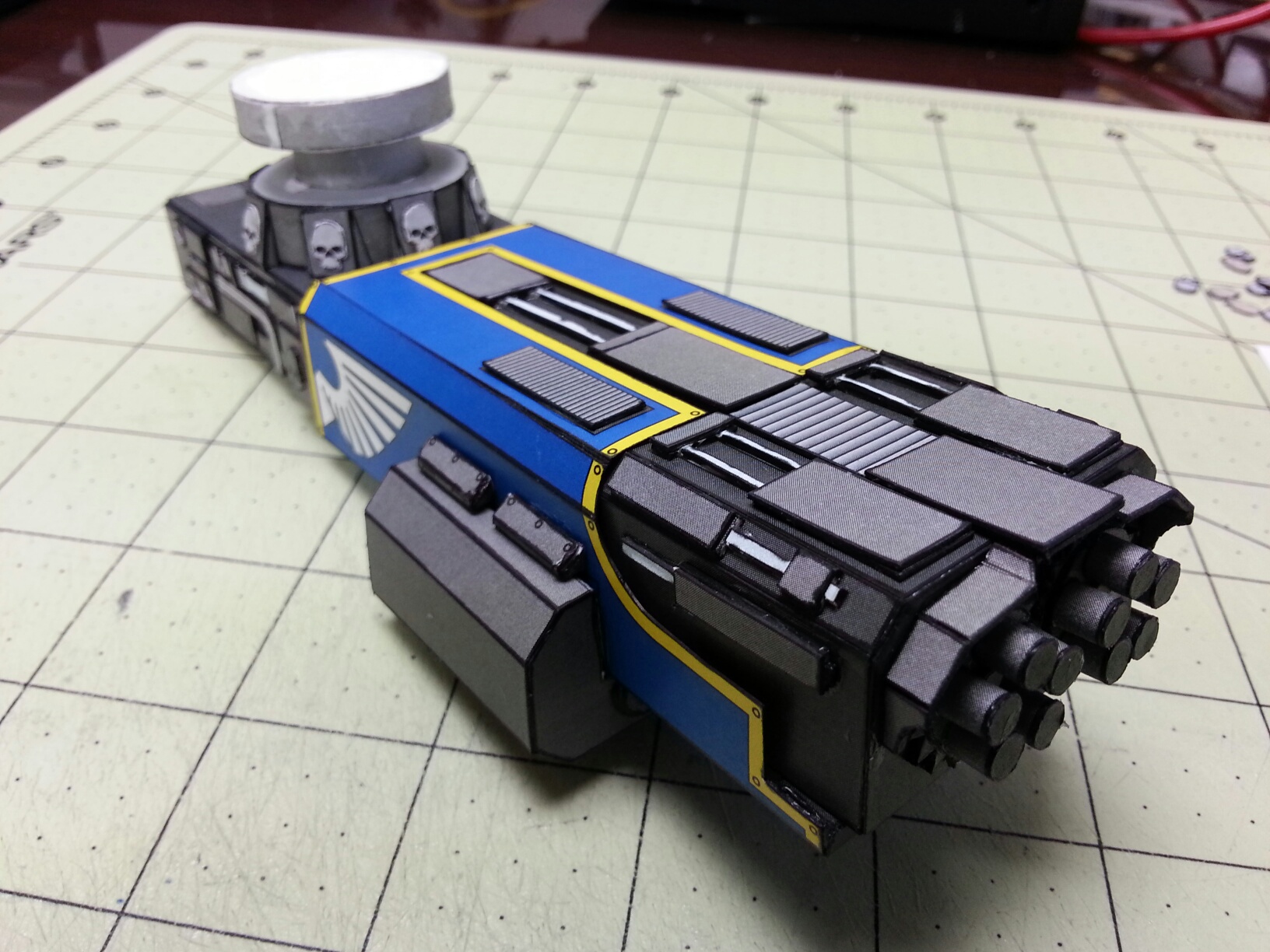

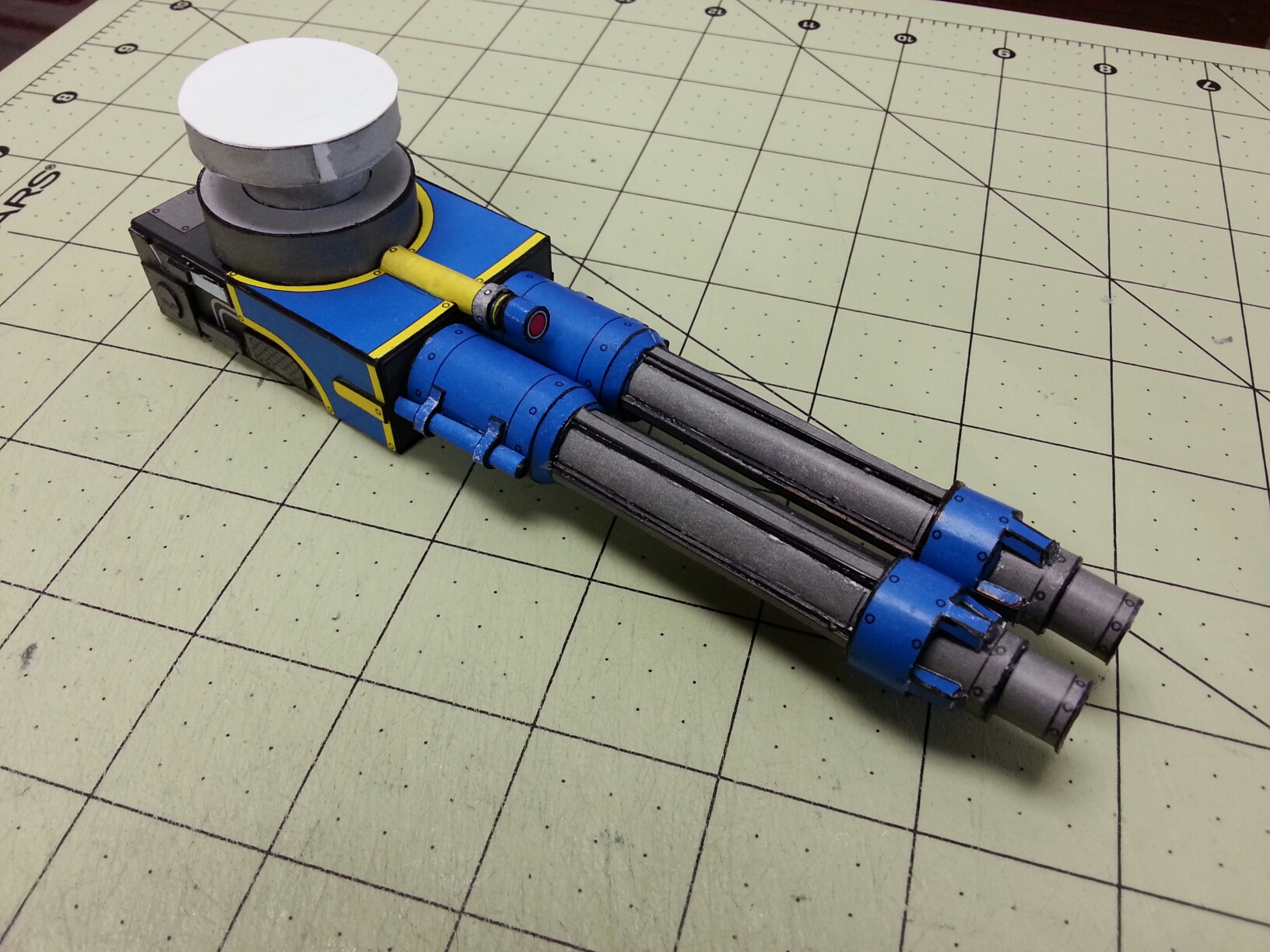

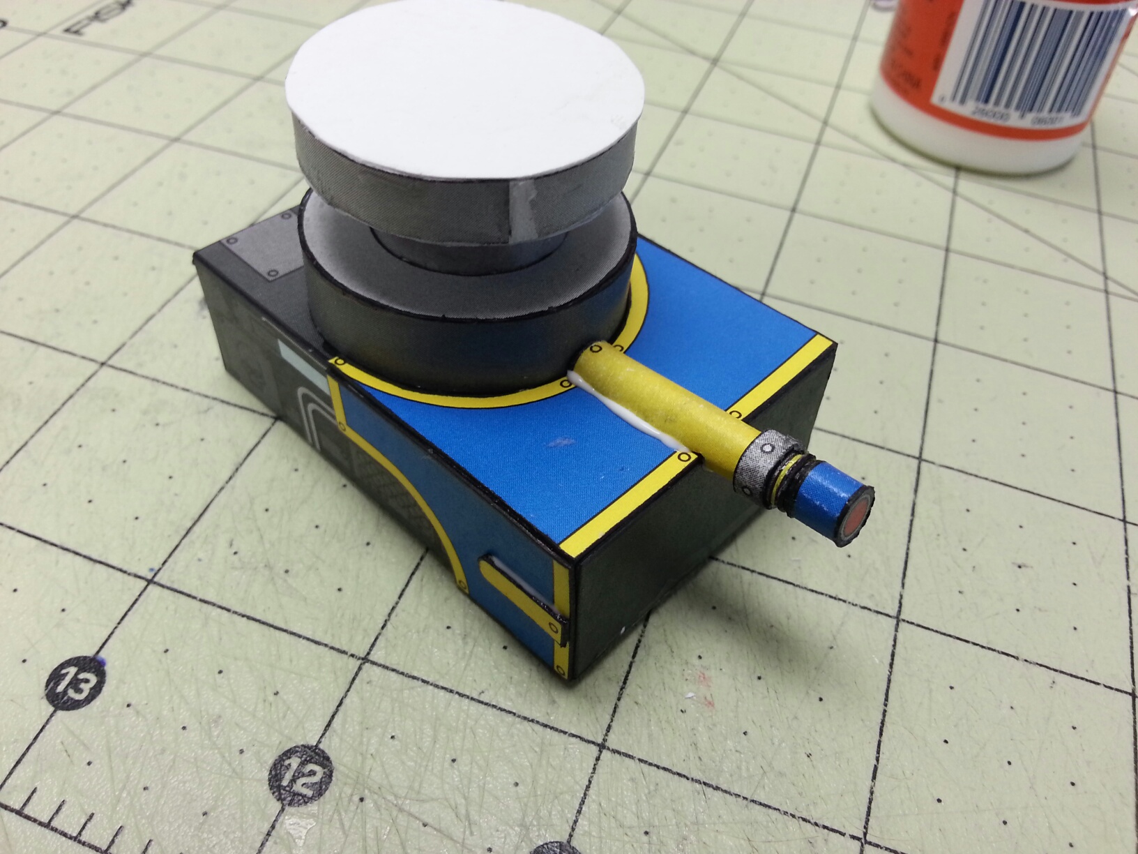

Lets start off with the guns I did finish today...
Inferno Cannon.... Unfortunately the big tank on the bottom had to go. It was hitting the leg.

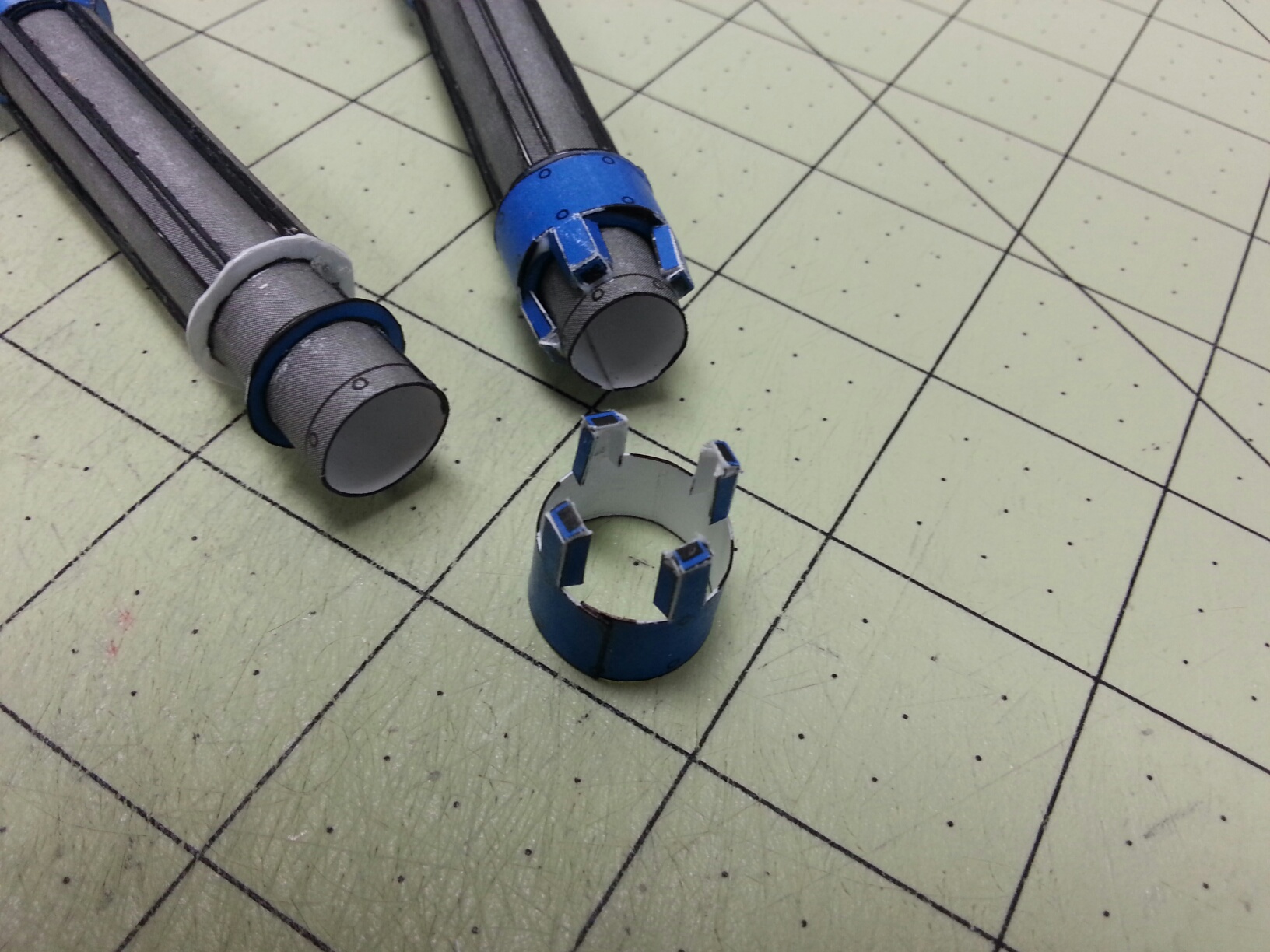

Alignment picture.... In order to get the tubes to line up, you have to put one on, them glue the whole assembly together so that you get a good placement. This way it doesn't have gaps where you don't want them.
Plasma Bastion. Complete with purple laser effect. (aww come on, it took me seconds to make that effect)
A needed picture for the final file... This is the part on top of the Plasma Bastion. It didn't fit with the rest of the gun on the page.

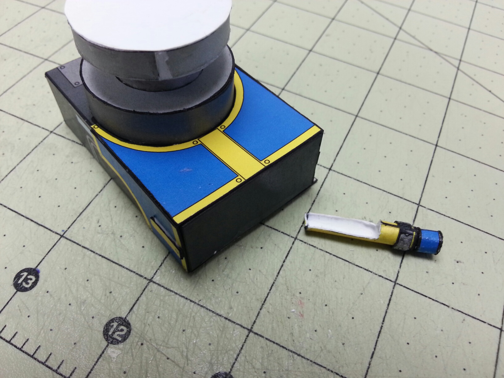

Now to the gun that isn't quite done and may be the bane of my existence at the moment.
The Mars Pattern Turbo Laser is the last piece for this. I hate having to redo plans just because things aren't going straight. The cans on the outside of the barrel, I initially made as one piece that the gun glued to.... Oh no... no way, that wasn't straight in the slightest. So I changed it and made the cans fit over the barrel.
Looking at it, that yellow thing looks like a pencil. but it is a laser site. I am going to have to show a pic of it after I cut it down. It is supposed to fit onto the gun mount.

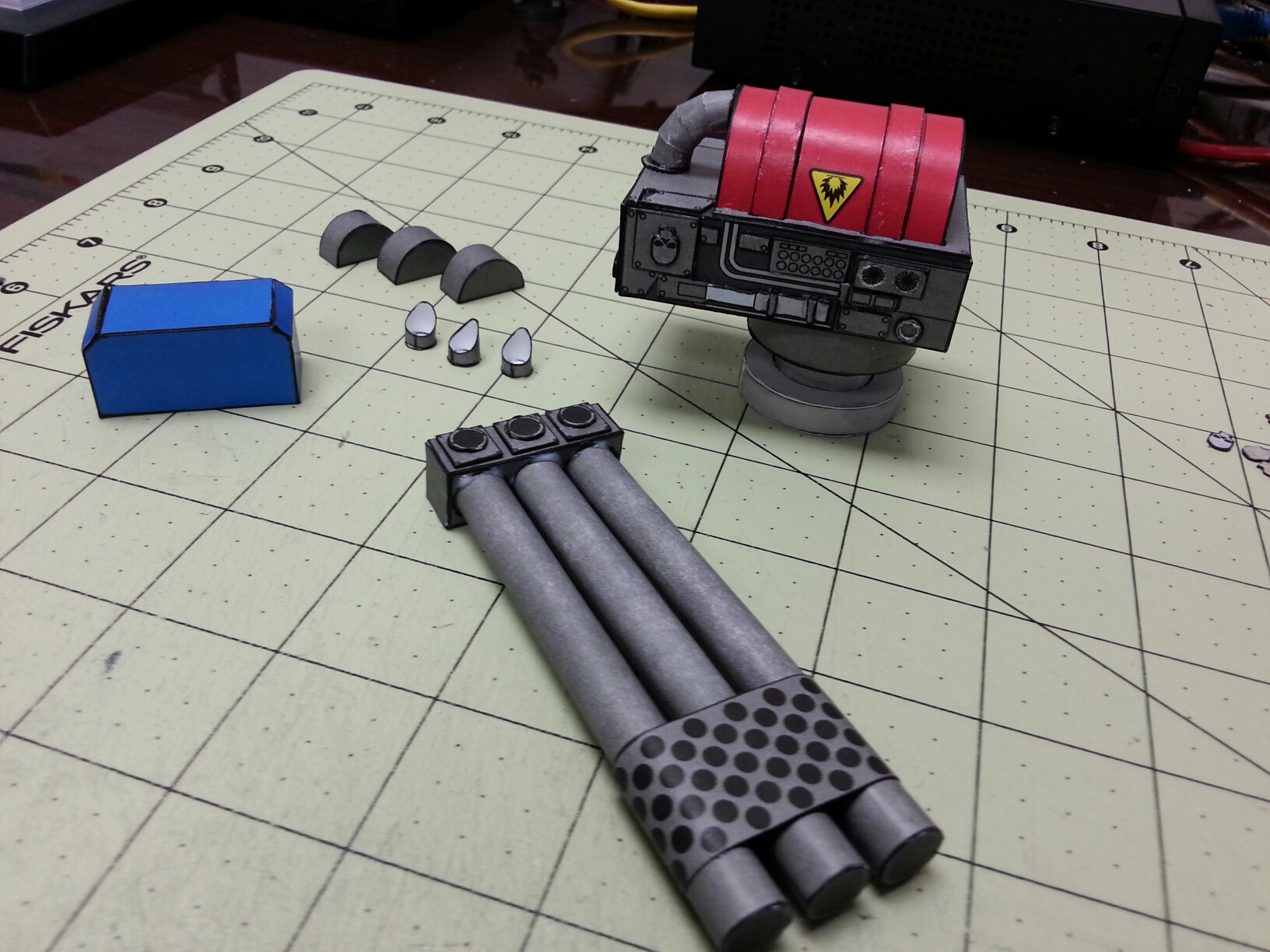

Lets get started with the last gun.
When you build it, you should build it like this..... Getting the whole thing to line up and the castle to look right on the barrels would be a pain. It is better to assemble it on the barrel and slide the castle over it.

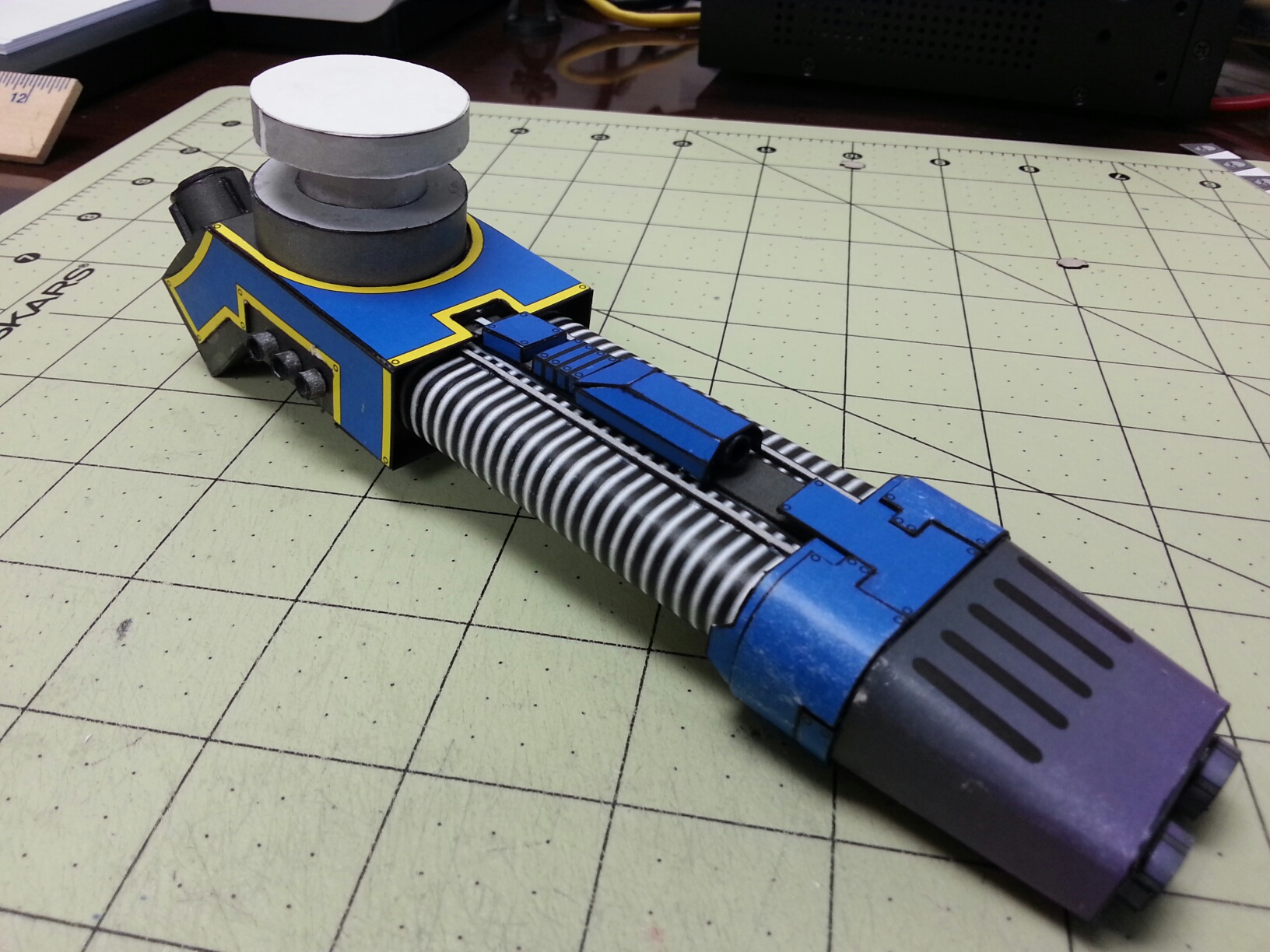

As promised.... This is the laser site. It needs to be sawed in half. (mostly) and attached to the mount. I provided a couple of reference lines for this.
Mars Pattern Turbo Laser.
